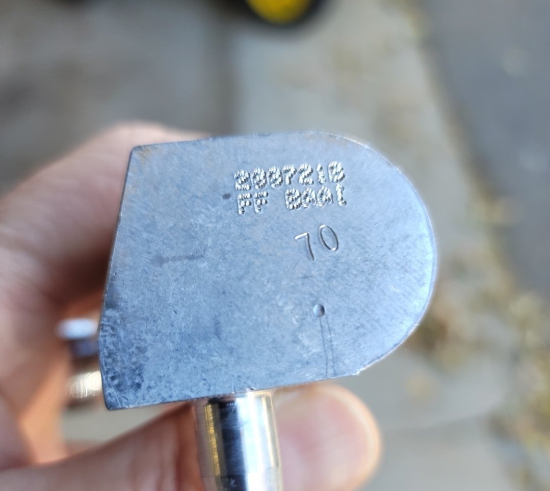

Just an update I upgraded to the new thermal bypass valve and during the warmer days it creeps to 190 not sure if I should purchase another to make sure.  Trans shifts fine. Fluid and filter change was done by the dealer.
Edited by Rickyace09
Are you sure you purchased the updated one? It shouldn't be running at 190⁰. Does it have "70" stamped into the end? Something like this:
Edited by mikeyk101
Oops, nevermind. I saw in your other post that you indeed had the one with the "70" stamped into it.
