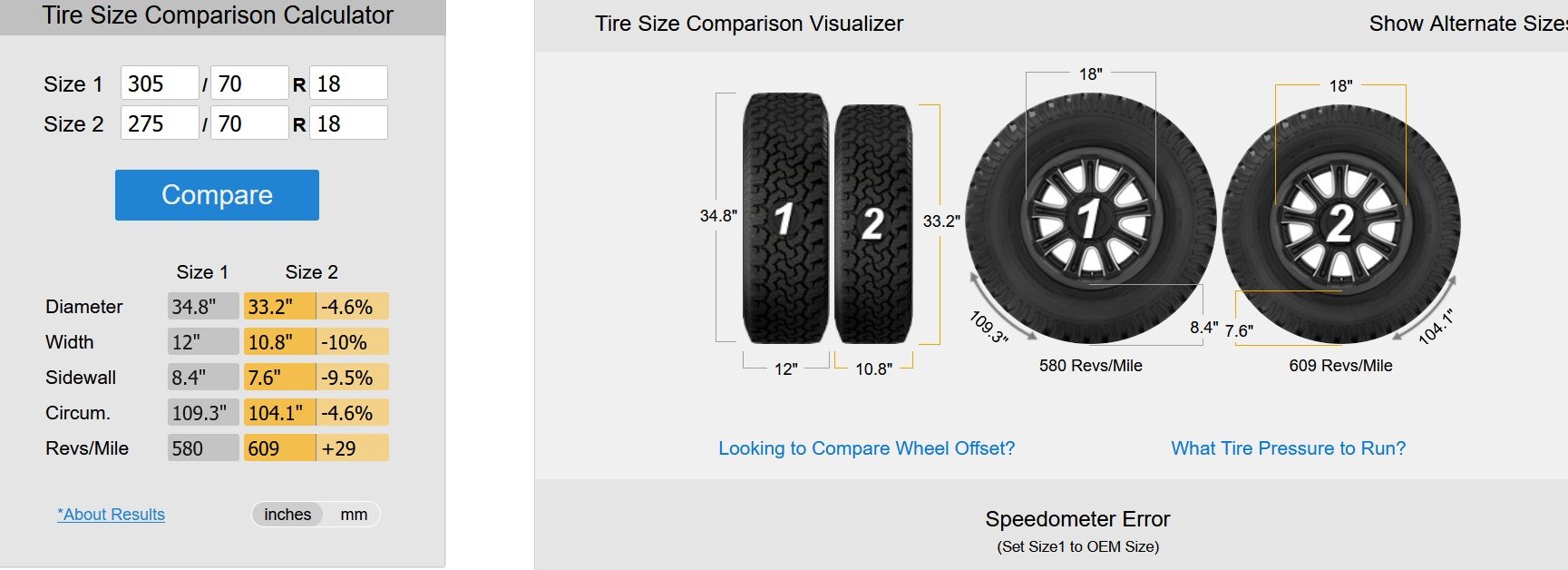

I'm surprised you could even fit the 275x70s without a level - I needed a 2" level to pop on some 33s back a while ago.
Edited by MikeBMW
275/70 fit no problem, no rub. I have 6112s now, which are good for approximately 2".
You need at least 2" more lift.
They may still rub with that.
Look into a real lift kit.
