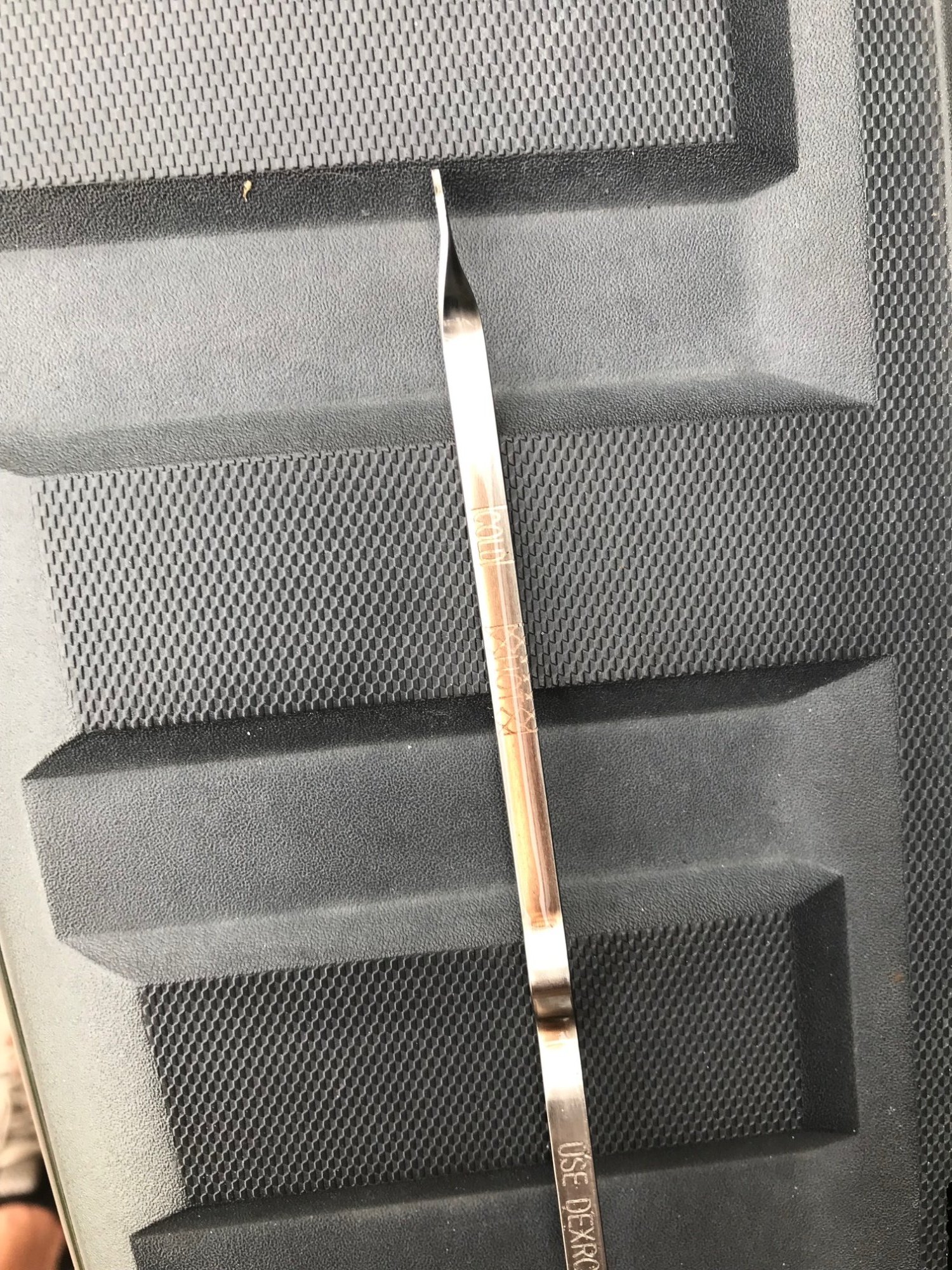

Here is how the dipstick reads hot...it's almost up to the bend in the stick.
Captain Obvious says that is too much fluid.
Update: Fluid level is fine. Dipstick was read while engine was off, instead of while running. Duh.
