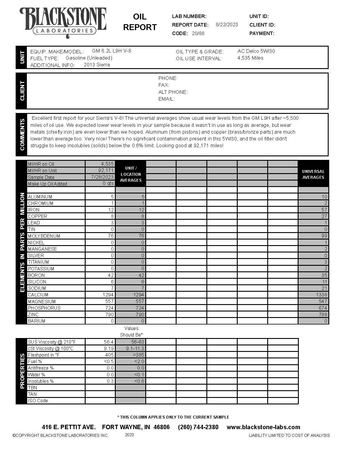

I run ACDelco oil in my trucks with great results.  We also started using Quaker State full synthetic, which we can buy at Walmart, in one of the trucks to test it out.  So far so good.  I'll do an oil analysis after the third oil change to compare it to the ACDelco oil.
https://www.walmart.com/ip/Quaker-State-Full-Synthetic-5W-30-Motor-Oil-5-Quart/177257743
Quaker State Full Synthetic 5W-30 Motor Oil, 5-Quart
