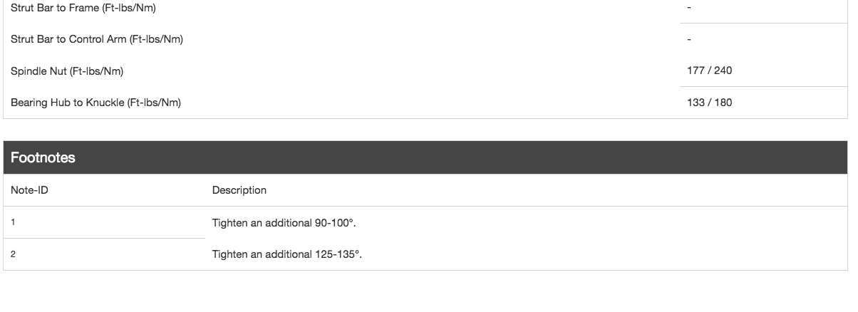

Yourmomsbediscomfy Posted March 21, 2022 Posted March 21, 2022 Does anyone know the torque for upper/lower ball joints, tie rod, and cv axle. 2015 Chevy Silverado 1500 5.3 4x4 rally edition
Duelin Posted March 22, 2022 Posted March 22, 2022 Found this, I don't know how it is going to display or if it will help you.
Yourmomsbediscomfy Posted March 22, 2022 Author Posted March 22, 2022 2 hours ago, Duelin said: Found this, I don't know how it is going to display or if it will help you. Awesome thank. But for example where is says upper ball joint then gives the spec it says 37/50 is that a torque between 37 and 50? Just want to be sure I get my truck back together with no other issues lol.
Duelin Posted March 22, 2022 Posted March 22, 2022 Where it says 37/50 if you look you will see ft-lbs/ nm. The 37 is ft-lbs. The 50 is nm (newton meters). Hope this helps. If you run into this again there are conversion chart for ft-lbs to newton meters and newton meters to ft-lbs. Hope this helps and clears up the confusion. Don't know if you noticed or not but if you click on the charts it makes them just a little bigger.
Yourmomsbediscomfy Posted March 23, 2022 Author Posted March 23, 2022 2 hours ago, Duelin said: Where it says 37/50 if you look you will see ft-lbs/ nm. The 37 is ft-lbs. The 50 is nm (newton meters). Hope this helps. If you run into this again there are conversion chart for ft-lbs to newton meters and newton meters to ft-lbs. Hope this helps and clears up the confusion. Don't know if you noticed or not but if you click on the charts it makes them just a little bigger. Very helpful. Much appreciated.
