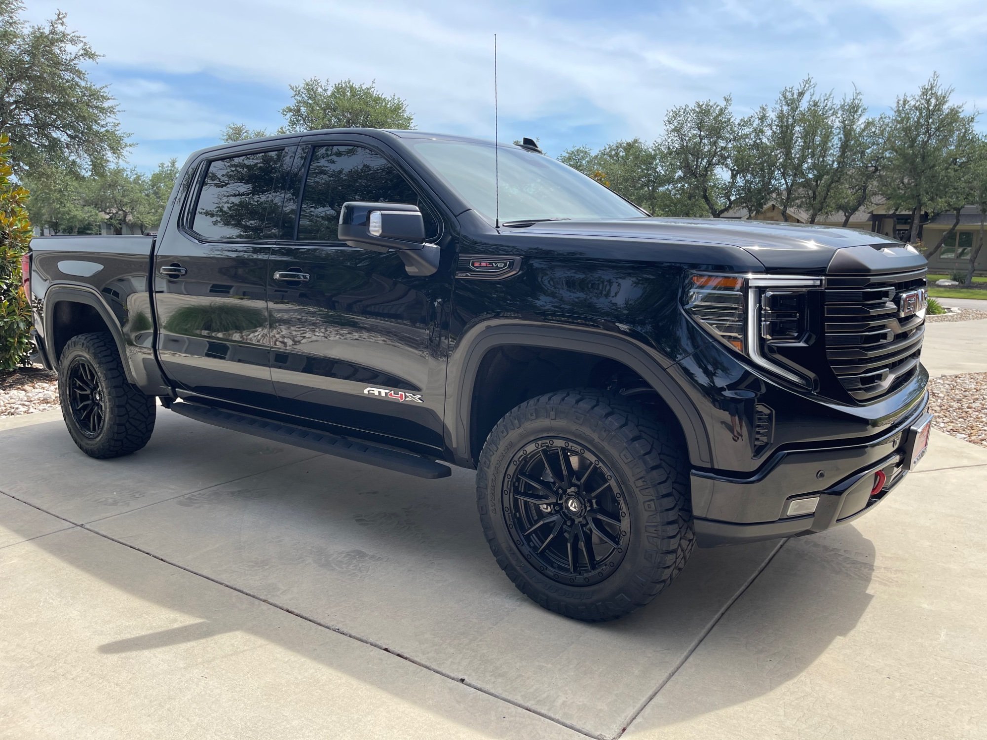

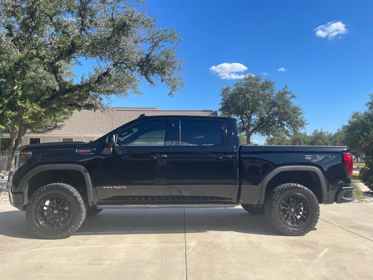

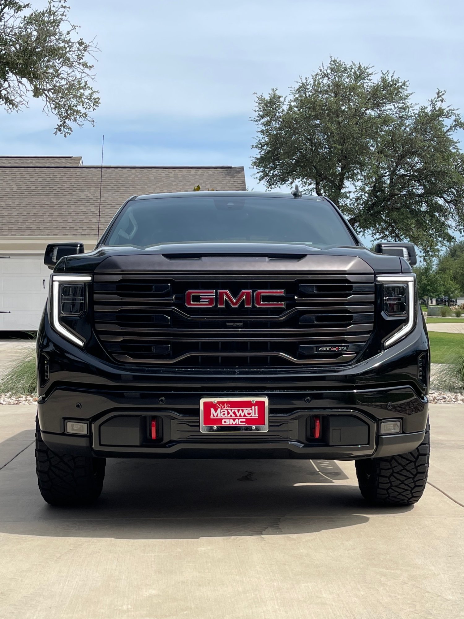

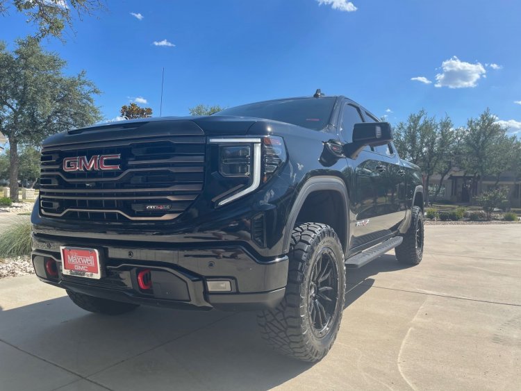

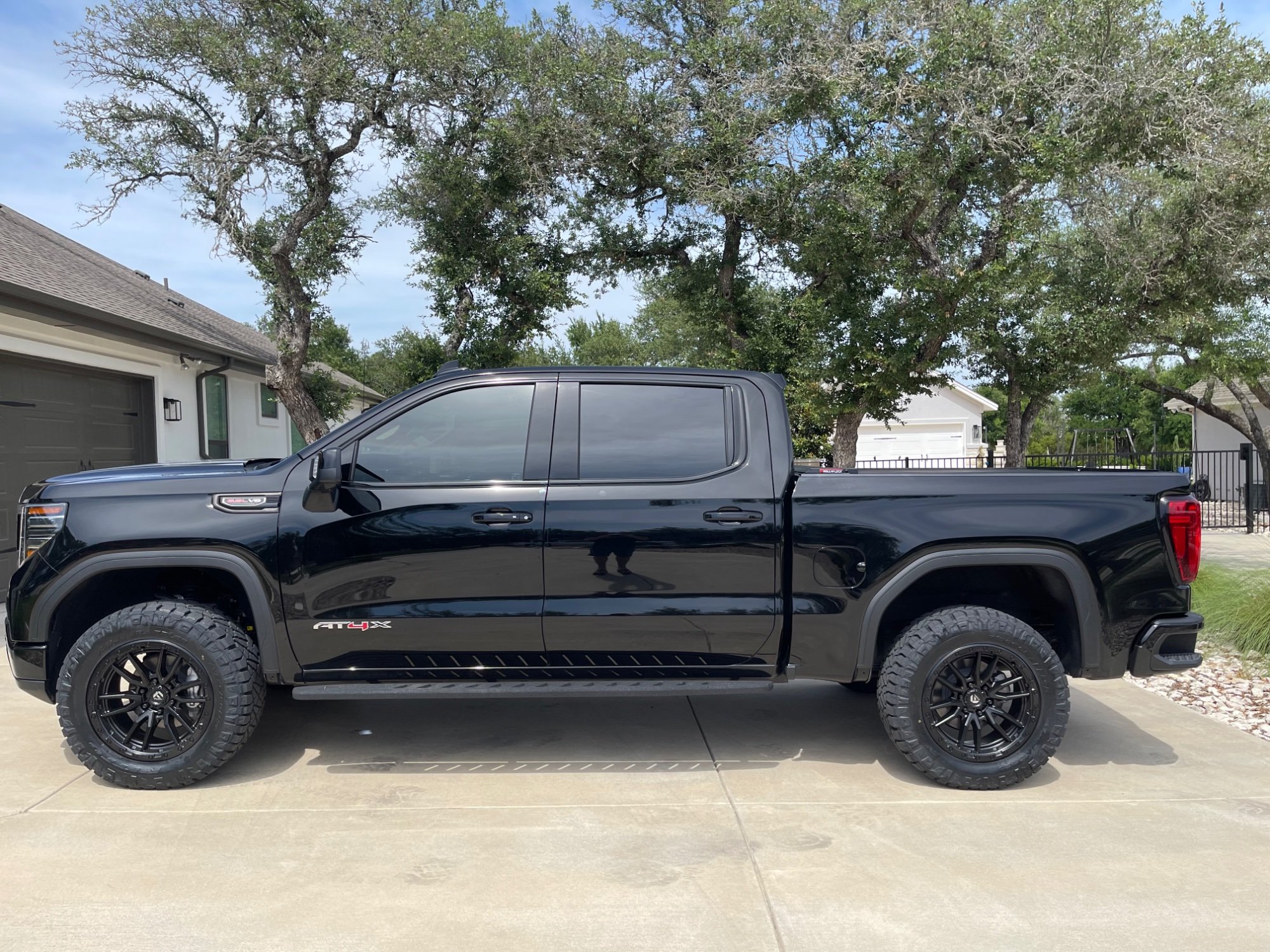

I was able to fit 285/60r20 (33.7x11.5) Nittos on Fuel 20x9 +1 offset wheels and really changed the stance from the undersized stock tires.
A little plastic trimming on front but I also removed the mud flaps and brackets for flap in the front fenders and that gave it the clearance needed. Loving the new look but you can see these could use a level!
