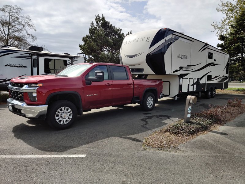

No experience with light loads, but others have, and can speak better to your points.
FWIW:
I've only towed heavy (14,300 lbs & 14,600 lbs) with a large frontal area (wide body 5th wheel travel trailer).  Tow-Haul mode works better for me at that weight.  Especially in the mountains.  Torque converter locks up earlier to control transmission temps.
The transmission programming in L mode could be better.  under heavy load it wants to drop down to L2 at over 5K rpms, even under partial throttle.   So I end up just slowing down, to keep it between 3,500 rpm-4,200 rpm.  It can still out pull a loaded big rig up a 6% plus grade (not meant as a brag, it just does).  I pass them going up, they pass me going down.  Rinse & repeat... lol
On the flat steady state cruising I can't tell any difference.
Fuel mileage in tow-haul mode has been pretty reasonable.  7.5 mpg to 8.5 mpg.  That is only a couple of miles per gallon off a stock '07 Dodge Ram with the 5.9L Cummins.  However, the Dodge did a much better job of maintaining freeway speeds through the mountains, both up and down.
Happy Trails! :cheers:
