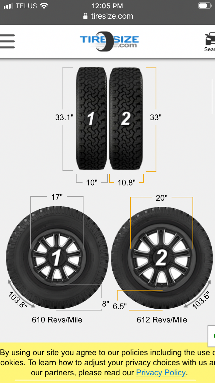

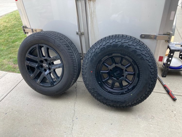

Factory 20’s from 2022 custom, with the very street 275 60r20 tires, weighed at 78 1/4 lbs and measures on the truck 32 1/4” tall.
New set up, 17’s with 255 80r17 load range E snowflake all terrains. 74 1/4 lbs and same 32 1/4” measured height.
New wheel Black Rhino Chase, 0 offset, 17x8.5, 25 lb, and tire spec falken at3w supposed to be 52.5 lb.

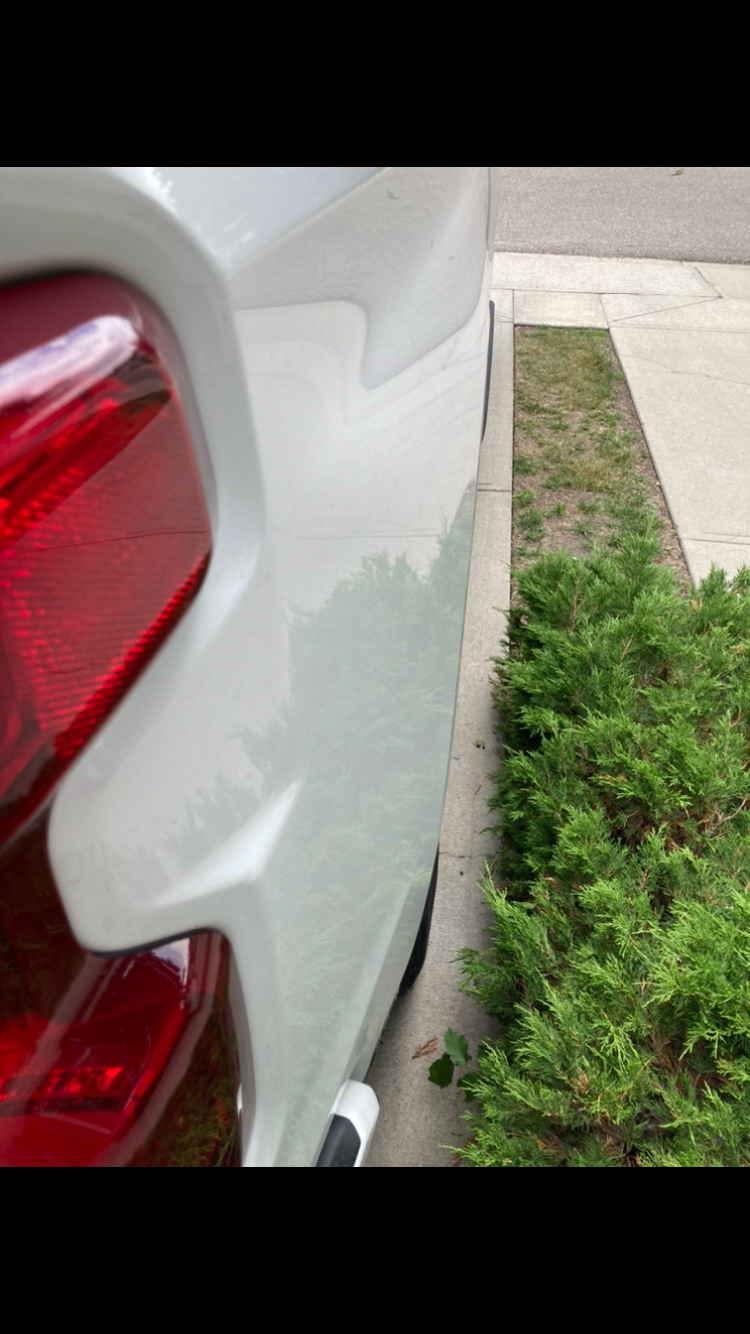

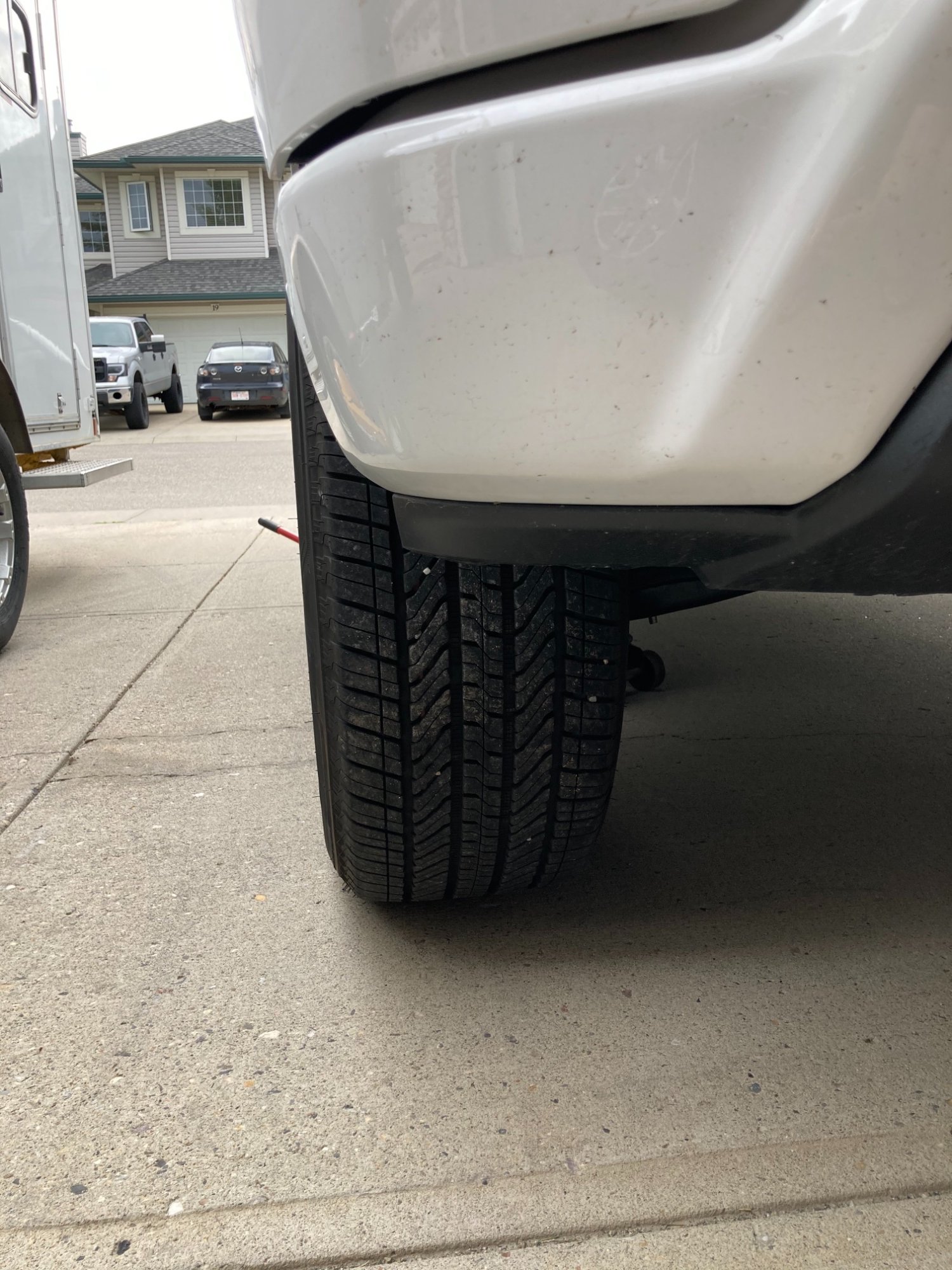

New set up has outside edge of tire 0.7” further out with 1.5” more clearance to the UCA side. I have 8” of sidewall now vs 6.5.
Ride feels same. Acceleration and stopping also. I was hoping for same weight making this change but losing 4 lbs a corner was an unexpected bonus while going to a more outdoorsman oriented set up. You can go 2 lbs lighter per corner with the Black Rhino Rapid Fyi and if I could have found some in the dark blue I would have.

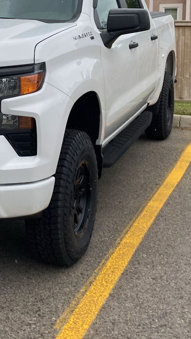

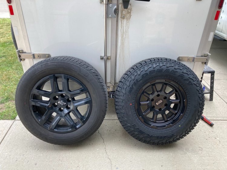

5A2BAFC2-B118-43F9-AA63-B11EB2B90EF5.thumb.jpeg.3bb3b9ce8fdfcded205e94e83db3bd4e.jpegBefore

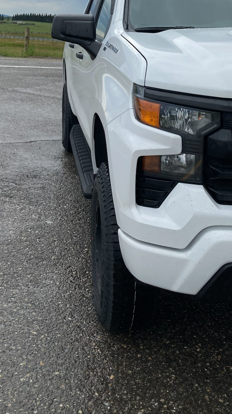

33A2EB33-F9C4-46B9-9682-95F1F95096EF.jpegAfter
Edited by 4banger

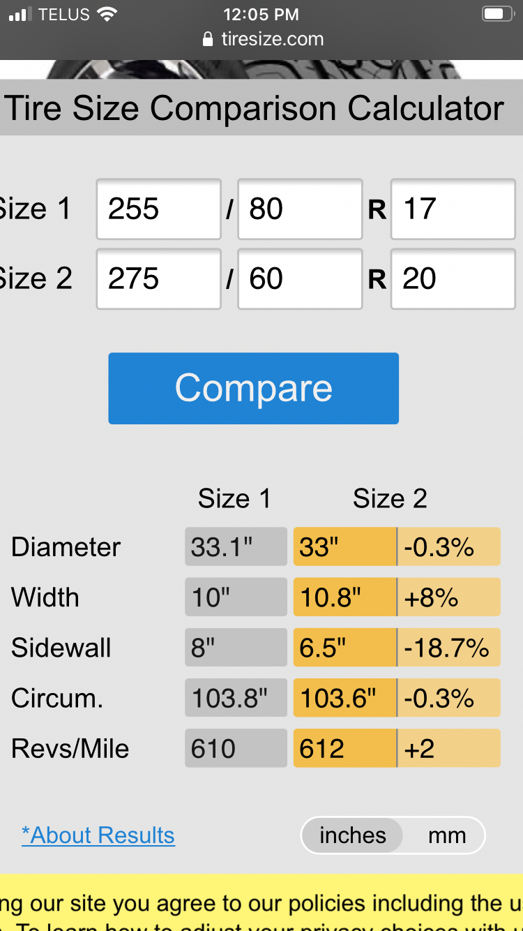

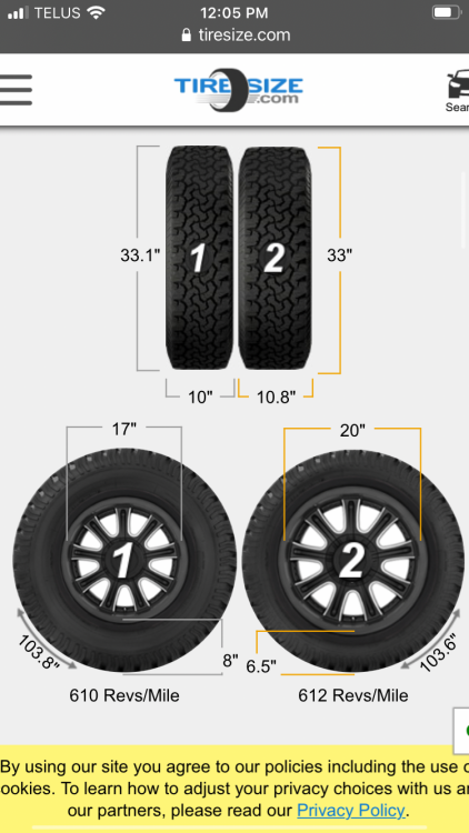

Before and after poke, guess screen shots can allow me two pics upload.

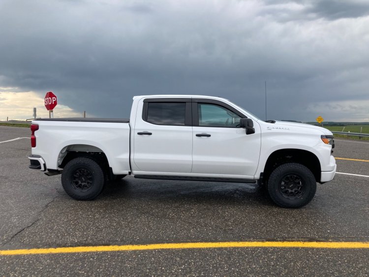

64923956-B3F8-4576-9F4A-66EAC3433E74.jpegModern highboy w/pizza cutters almost done. Some airbags and lighting going in and likely spray box liner the inside rear fender wells to deal with that awful white in there. Be ready for a little blood in the box come fall. If only I could have had this with a manual transmission and a nice heavy flywheel...drool. 😉

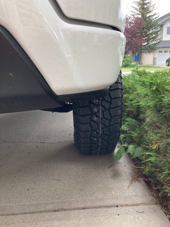

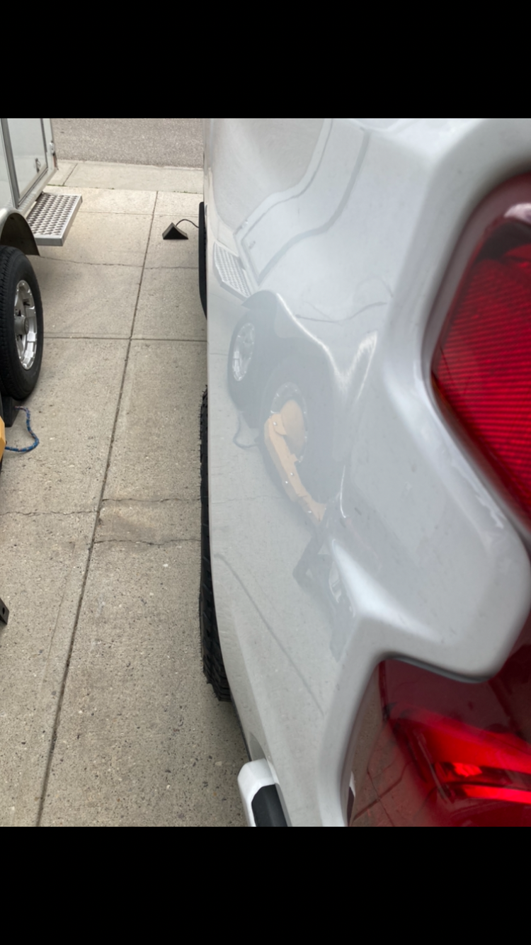

Here’s a good picture of what I did here.
