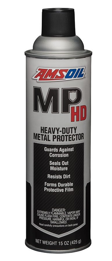

You can do all that or just hit it with AMSOIL's Heavy-Duty Metal Protector.  Just spray it on the exposed metal where the wax came off and you are good to go. Do this at least every fall and spring if needed.  It will not effect the factory wax coating.
AMSOIL  Heavy-Duty Metal Protector

According to Amsoil , this product contains solvents, oil, and ethanol.  This will destroy the wax coating.
Section 3 of This data sheet

I haven't had any customers that used it have any problems but can see your concern.  I'll spray it on my 2019 wax frame and see what happens.  I don't need it down here in southern part of NC like the north does.

Dude is an Amsoil dealer, his post is just an advertisement.

I sprayed my waxed frame with AMSOIL's Heavy-Duty Metal Protector and it has been two days now and the wax coating is the same as before I sprayed it.  It doesn't effect the factory coating.   Just wanted to let you know.
