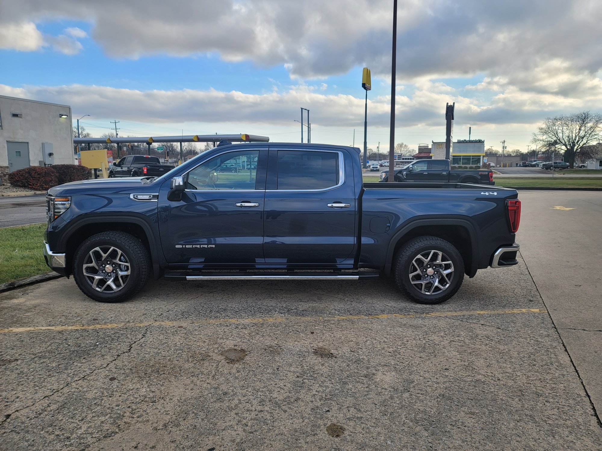

Recently bought a 22 refreshed sierra 1500 slt and absolutely love the ride quality. Its honestly the smoothest truck ive ever driven. I want to put 34-35s on it with no rubbing but am afraid this is going to change the ride. I'm willing to spend alot on a high quality lift. Does anyone have any experience on before/after their lift and change in ride quality/steering?
