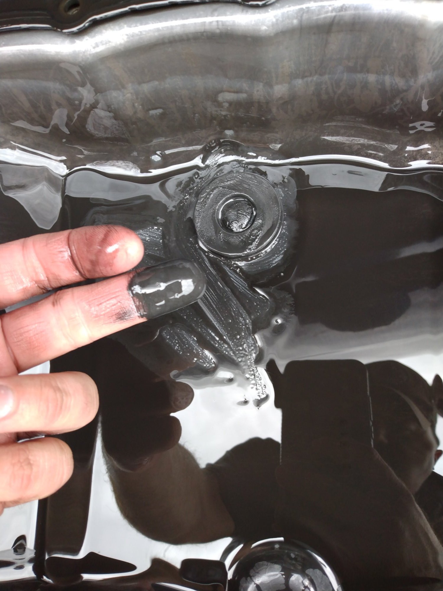

I was reading in another post of yours that the 4.3 V6 has a different torque converter? Do you think by the looks of the pictures of the pan that in fact my torque converter with the 4.3 V6 is in fact failing? and if so what torque converter would you recommend replacing it with, or just replacing the whole transmission ? thanks
To my eye that looks like clutch lining mud. Slipping clutches. Either just wore out OR some internal leak bleeding off pressure. Worn valve body? Cracked apply piston? Either way, a rebuild or replace is in your future. Sorry. Oh, including the converter. It will be full of that stuff.
