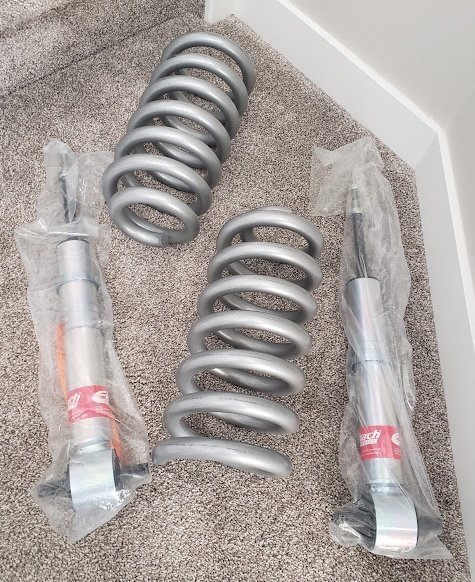

I recently got a pair of the Eibach Pro Truck Coilover 2.0s to level out the front of my truck but before I install them, I'd like to know how much they need to be adjusted to level out the front. My truck is a v8 4wd and has the 2'' factory rake. I saw Eibach says these coilers are adjusted to be level with the rear but I am not sure. Does anyone know how much these need to be adjusted to be level? Thanks!

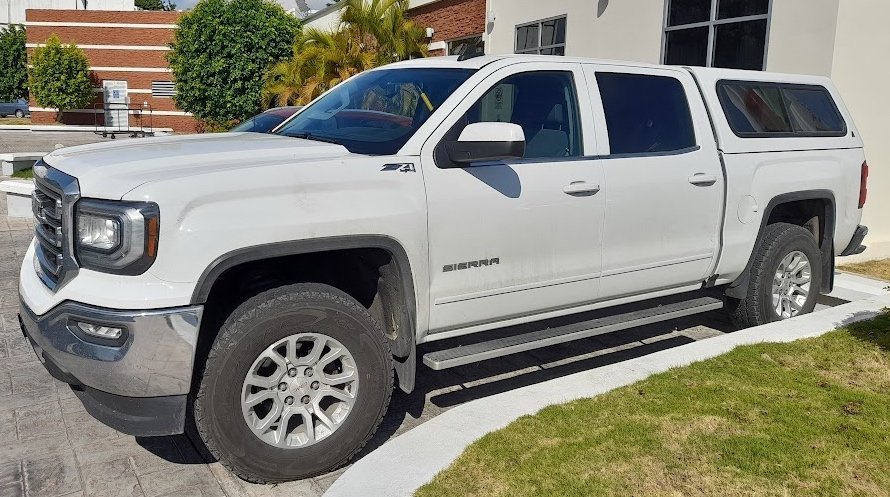

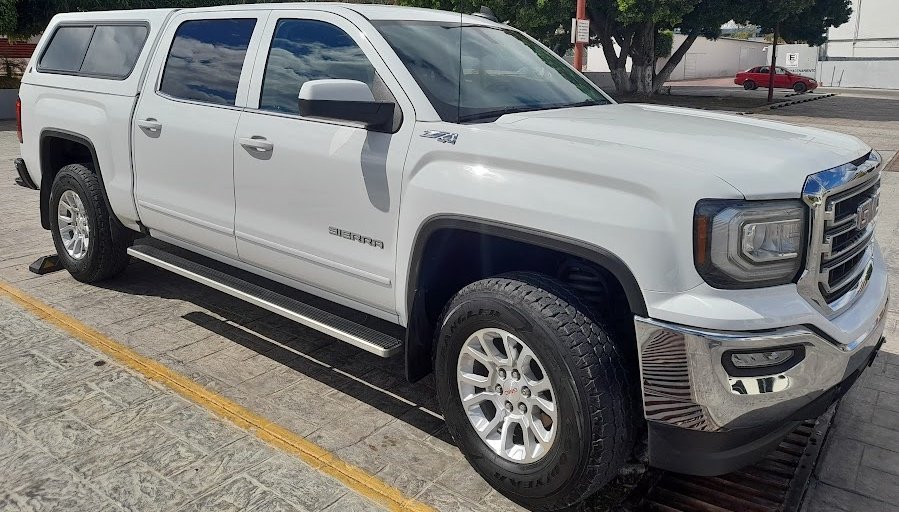

I installed the same Eibach kit on my 2018 1500 V8.
I had the shop install it "as-is" from the box, no adjustment. If i remember correctly, this was the lowest setting as pre-set by Eibach. I upgraded the rear shocks as well. The tires are 285/65/18.
It was a perfect front end level in my opinion. I added a 2.25" rear block for additional 0.75" just to maintain the slightest rake since I tow stuff fairly often.
Drove it from Canada thru Mexico and Guatemala to El Salvador and back, highway, backroads, off-road.....I love it.
