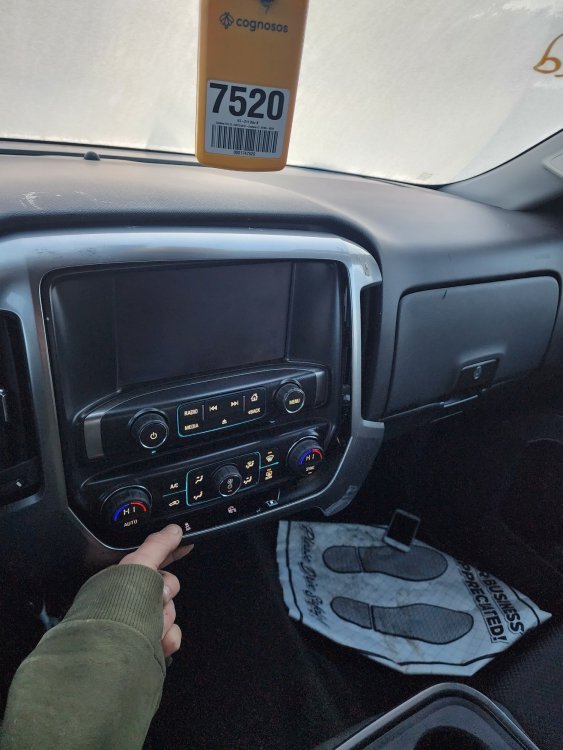

I transport cars for a living. Recently discovered that trucks without heated seats have the plug on the bezel. My question is, can I just buy a bezel with buttons to have them work? Not sure if trucks have the heating elements or plugs under the seat. Any knowledge?
The seats don't have the heating elements in them and possibly the wiring to the seat for it is missing. But if you change the seats and buy a harness from harnessdr.com and the panel with the switches (which i have if you want) seats too
