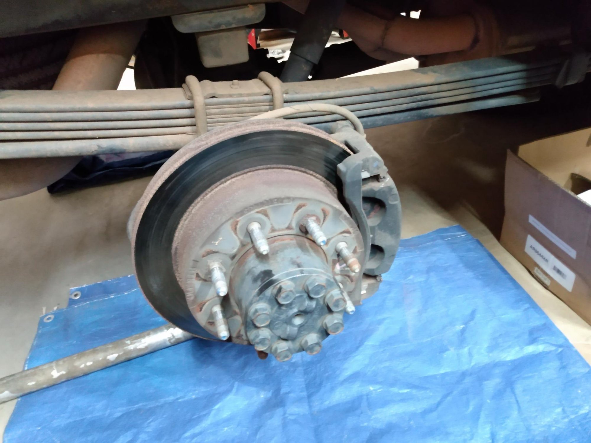

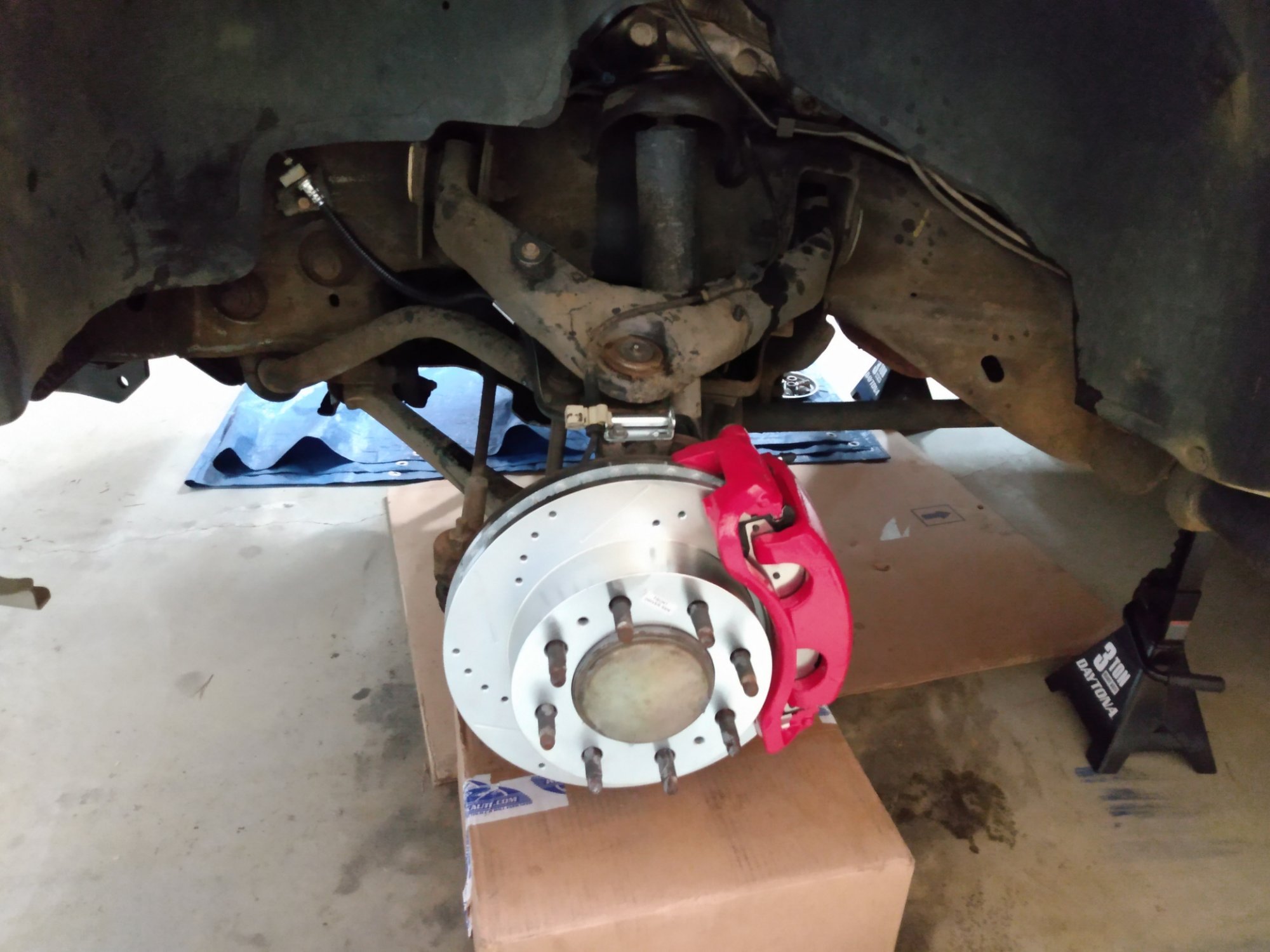

I replaced all of the brake parts this weekend (Pads, Calipers, Caliper Brackets, Rotors, and Hoses). I did not need any of the parking brakes or hardware. Those looked like new. I just cleaned them up and attempted to adjust them. I also bled the brakes. It appears that there is still some air in the system and I will need to bleed them again. I will also need to adjust the parking brakes more. I may also need to check the parking brake cable for any wear issues or adjustments. The NEW rotors are just as thick and heavy as the ones that were on there. The NEW caliper pistons looked to be slightly larger than the old OEM ones. The old rotors look like they could be turned and still have life in them. The old pads had half life left on them. Everything but the old pads looked to be OEM original. The truck has about 180,000 miles on it. I got it with about 160,000 miles on it. All that I know about it is that it was a work/fleet truck for the local EMC company. We do towing and 4-wheeling with this vehicle so I figured it was time for some maintenance and an upgrade.
Adjusting the passenger rear parking brake is a real pain. I will need to buy another short to medium screwdriver or maybe a brake spoon to adjust that side. The adjustment hole is at the top and the leaf springs are in the way. I see no leaks and other than some adjustments everything seems to be working fine.

Yes, adjusting that one side sucks.  It's worse on my '04 3500, as it's a cab&chassis with a narrower rear end, so it's even nearer the spring pack.  I use a custom-bent spoon, a mirror and a light to do it, after pre-adjusting it near to size by putting the hub on/checking/taking it off/adjusting the brakes/repeating, then putting on a new inner seal in the hub and installing it for real.
It does suck to spin it the wrong way. But it is as adjusted as it is going to be for right now. I have everything done and it rides and stops good. My wife wants me to clean out the master cylinder and fill and flush again with all new fluid. I guess that is another project for another day soon. It looks like I have issues with some broken exhaust manifold bolts too. And yet another project.
