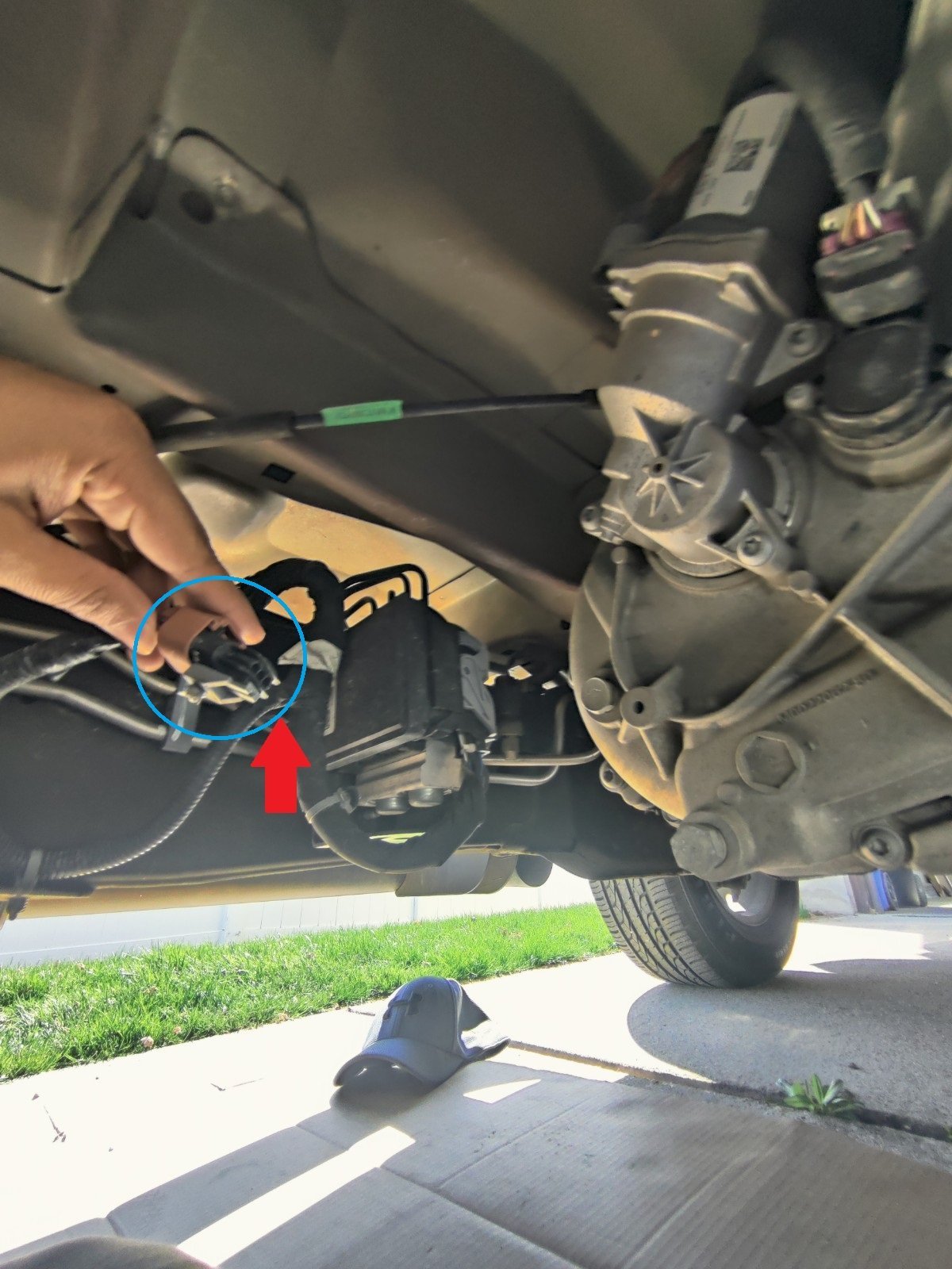

I have a Silverado 1500 2017 LT, days ago I noticed that there is an unplugged wiring harness down below my truck, the harness comes  from the ABS pump module harness,  It isn't long enough to plug into anything and there are no missing connections anywhere. I attached some photos. I do know what it is to or where it goes, thoughts?  thanks.
That's for the flex fuel sensor that your truck does not have installed. The harness is the same for every truck and they just put the dummy plug into the end of the harness to keep water/debris out.
Just zip tie it back out of the way.
