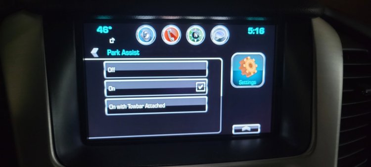

What exactly does the "On With Towbar Attached" setting change about the park assist?  I have not noticed any change.  When having my rear mounted cargo basket attached, the park assist system will automatically disable itself after sensing such a close proximity that doesn't move after a certain period of time, regardless of the infotainment system setting.  I really wish the rear park assist could be disabled separately from the front sensors but that's a pointless conversation given how little I use a cargo basket out of a full year of driving.  From my research the owner's manual doesn't describe this setting.
