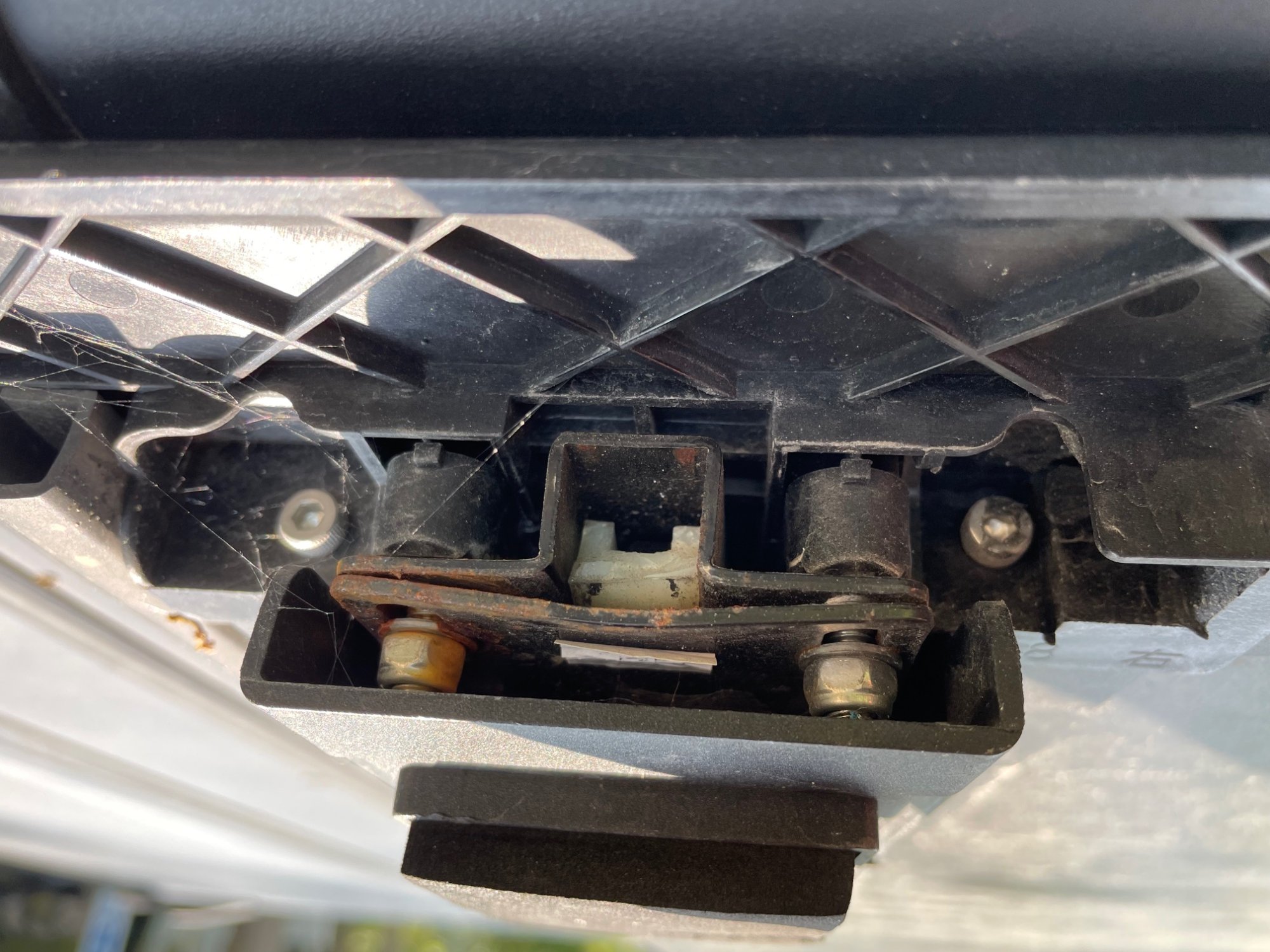

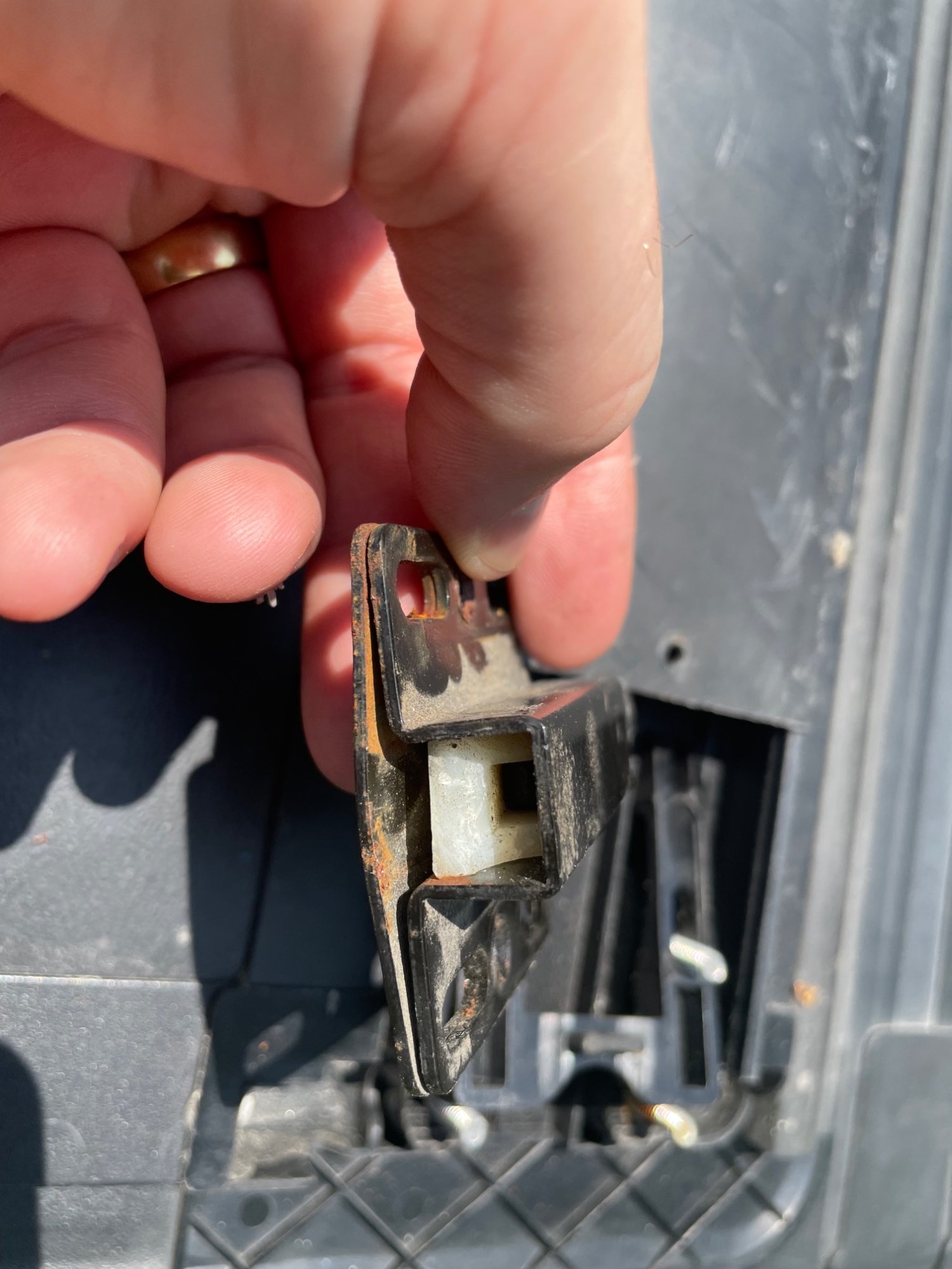

Rear latch broke on my tonneau cover for my truck bed. I can’t seem to find a replacement latch/trigger. Anyone know where to find a replacement?
My tonneau model number: LGH-B55
I have a 2021 sierra 1500 crew cab.
Short Bed/Box: 69.9 inches
IMG_1922.thumb.jpeg.74fdadcc23e2edf7bc8e82b98779087d.jpegIMG_1831.thumb.jpeg.d0976a5d533c39f5dbe5df90f8737e8c.jpegIMG_1921.thumb.jpeg.b075d0981903aaaff40ebb4719854bd1.jpeg

Check this out it seems to be it.  Compartment Door Trigger Latch - Flush Mount JR Products RV Door Parts 37211705 (etrailer.com)
Or Amazon.  Amazon.com: JR Products 11705 Flush Mount Compartment Door Trigger Latch : Tools & Home Improvement
If that is a GM cover you can contact the dealer parts dept. and ask them who makes it for the life of me I cant remember who makes it for GM and go that route but it appears the 2 above sites it is the same except for the slide holes but you could always drill it out and make your slide holes.

Thanks for the reply. I actually purchased that exact one. Tried to install it yesterday and it doesn’t fit. The width is to short.
Read the bottom of my post you replied after I edit it and dont know if you seen it.

Another option would be if you can take your old latch apart and the new one you bought apart and see if the nylon latch clip is the same and swap it.

I wish you had provided more info, or better pictures, on the make/model of the tonneau.  It kind looks like a Retrax cover, but also doesn't look identical.  Retrax provides GM tonneau covers under a different label.  If it's their off brand you might be about to find replacement parts on Retrax's website.
