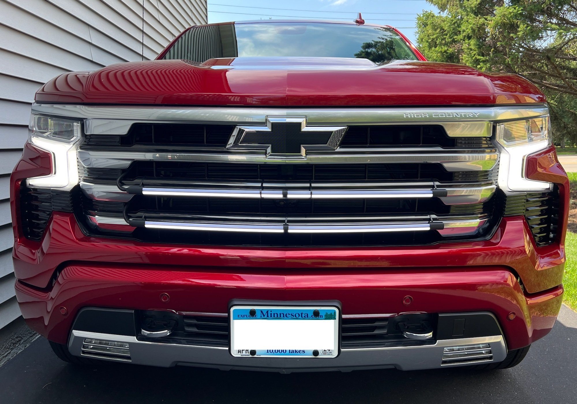

I did add some Putco Virtual Blade LED Light Bars on the front, so this fills my desire for more front lighting during the day and works very well.

Can you show us how you mounted those ones please?  TIA

Putco has 3 integral clips that use cable ties, one on each side and one in the middle. Works well if your grill allows mounting in those locations. The top one on my grille has the camera in the middle so I had to use two cable ties, one on each side of the camera to make it work.
Also, I put 3M waterproof industrial VHB tape on the back of each clip to solidly hold it in place on the grill.
The Putco LED lights don't show so well on camera, but are nice quality and bright.
