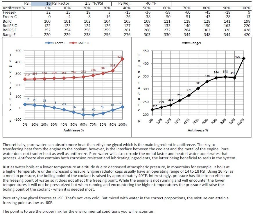

Pure water sounds like a good idea but it's not because antifreeze has additives that give the mixture better adhesion to the metal in the water jacket and therefore better heat dissipation.
Here's a graph I put together that you might find helpful.AntifreezeMix.thumb.jpg.f870ddd9e5f9fbe6dba301387b13b6ae.jpg
I had no clue. (Obviously). Not sure how much pressure my cooling system was holding because after I added “kseal” I started hearing pressure release from the reservoir after removing the cap. Thank you for the explanation!
