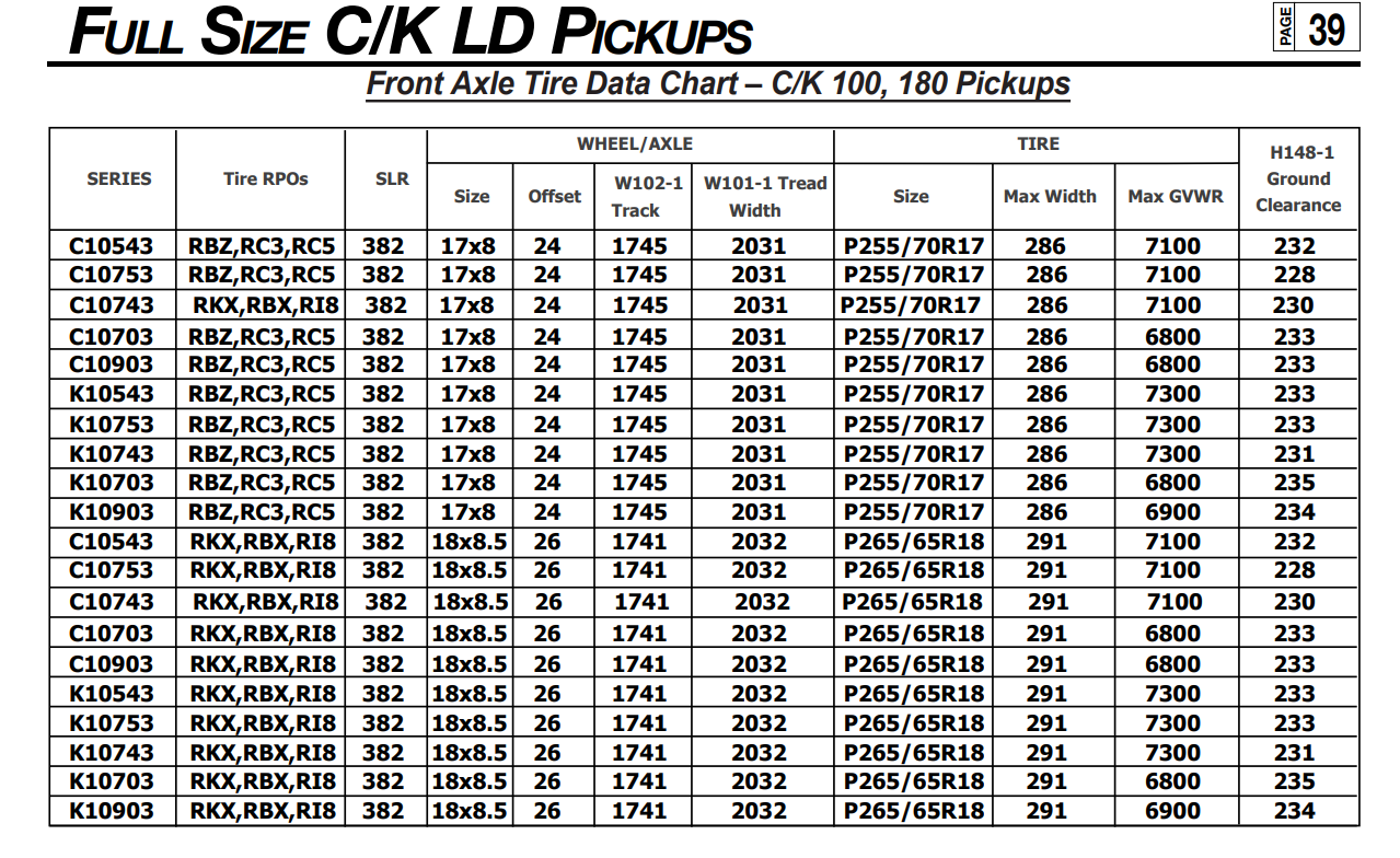

2023 upfitter guide lists 24 and 26 offsets on 17 and 18" wheels
Didn't find where/if there is a listing for 20's and 22's
Saw a picture somewhere that showed a build-out on the outboard side of some of the calipers. And it was this that some wheels were making contact with, preventing them from being used.
