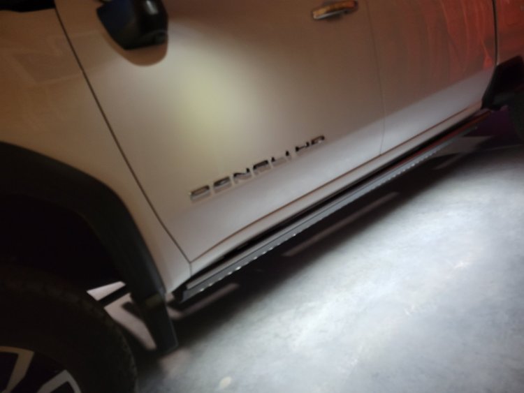

On the AT4 forum someone mentioned the driver’s side LED lights on their factory running boards were not working (2024 Sierra HD AT4).
I checked mine and the driver’s side running board lights do not work but the passenger side lights work.
A few other people noticed the same thing, some had taken their’s to the dealer (including me) and although one person has had the module changed no one has said the driver’s side LED lights are working.
I’m wondering if it is a software problem and not a problem with the lighting module or the LED light strip in the driver’s side running board.
Does anyone here have a 2024 HD with a driver’s side running board light that works?

Try looking at the front side of the LEDs. Mine had a bunch of road grime and water in it. Looks like it may have shorted out. At the dealership now. I will see what they say but probably going to have to replace the LED strip
2024 Denali ultimate here. My lights work fine, however, one bulb is out on the drivers side. Took it to the dealer (for another issue) and let them know, they found water in the light and ordered a replacement (waiting for it just like everyone else). Apparently, there is an issue with the drivers side not being properly sealed.
