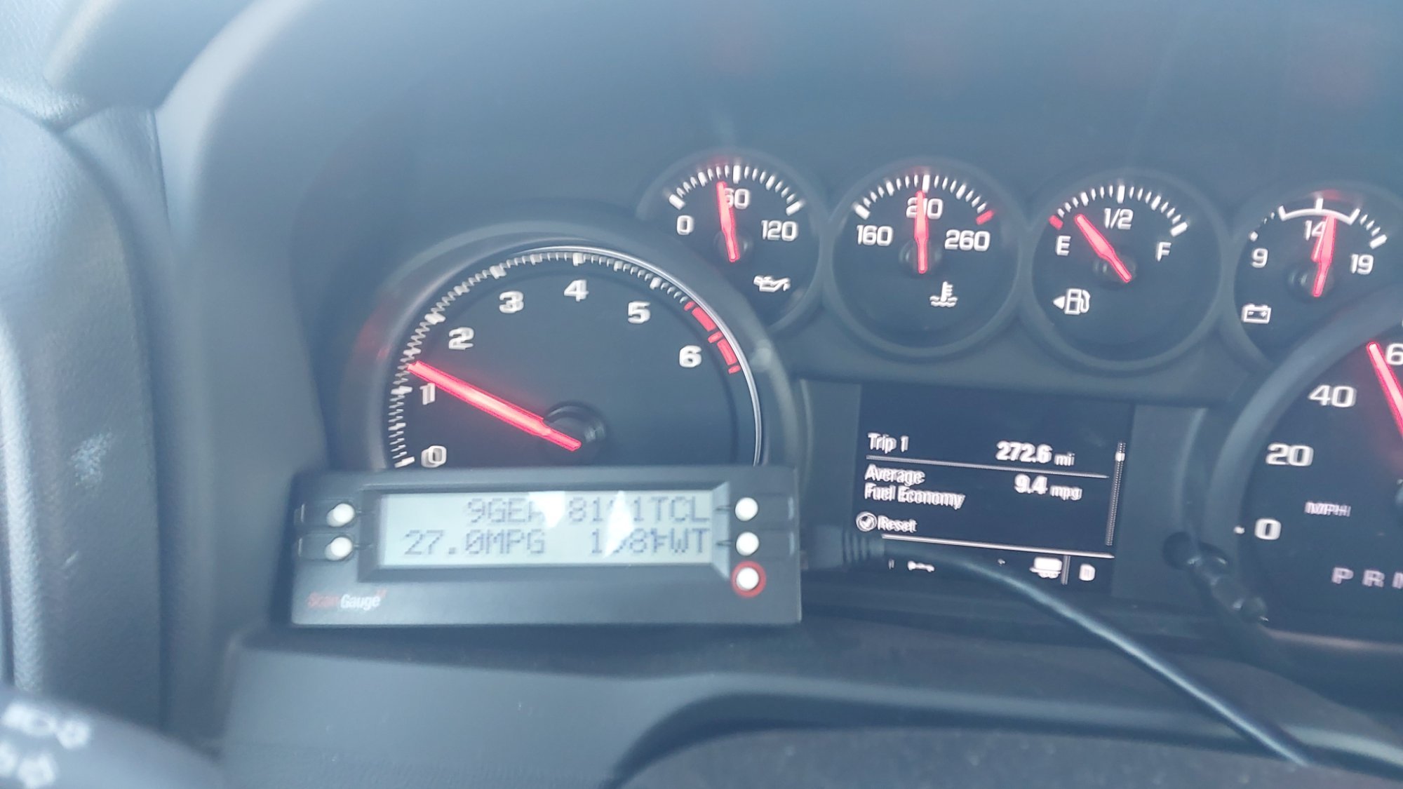

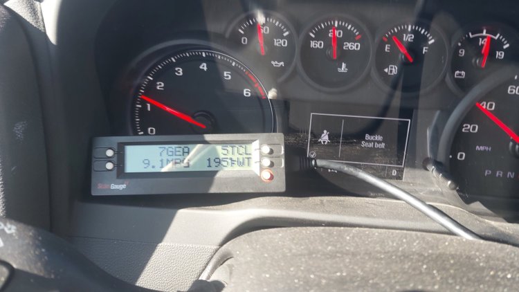

I will be buying the scan gauge 3 Monday, as the gear indicator does work, at least on my scan gauge 2. Torque converter slip works also, but I do not have it understood yet. I was looking for lock up. Here is the info from scan gauge telling you the info for the x gauges.  The 2 is just to small to keep messin with, but it does work. I labeled mine gea and tcl:
Our engineer believe these two would work.  He focused on what you were after first and what he already know, but he'll look into finding anything new time permitting. Let us know how they work and if you have any other question don't hesitate to let us know.
TCC Slip (RPM)
TXD: 33F1221991
RXF: 046205190691
RXD: 3010
MTH: 000100080000
Transmission Gear (#)
TXD: 33F122199A
RXF: 04620519069A
RXD: 3008
MTH: 000100010000

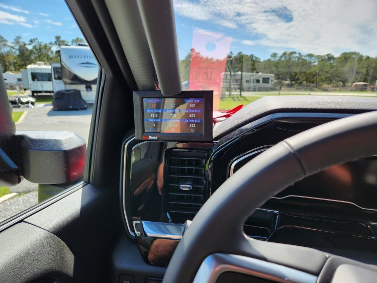

I put the codes into my SG3 and called the display "Gear"  When I started the truck it showed "1" no matter if it was in D,R or Manual select. Its blocked inside the barn right now all clean and warm while it rains and sleets outside. Not willing to waste 2 hrs of cleaning to test it our right now. Maybe if we get a nice day this week. I will post the results. Thanks for the help.
Mine also says 1 all of the time, except when moving. No big deal to me. In case someone else was interested,The cheapest I was able to find a new one was at auto zone. I saw that someone on another forum posted about it, 20 % off which was a good savings compared to what I was finding. Shouls be here next week sometime. May be cheaper somewhere else.

Scan Gauge had ask for me to let them know if it worked or not. I let them know this morning as they were closed over the weekend and mentioned about the 1 for park and reverse and first. This is what they said:
 If Park, Reverse, and 1st Gear all report as 1, this is how the manufacturer reports these through the ECU. It is not uncommon for Park and Reverse to share the same value, as well as with 1st gear. If you have any questions, please let me know.
