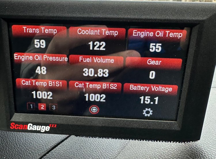

No dice for the gear x gauge with the 6spd. Just displaying 0 at all times. Oh well. I put total misfire count in it’s place and removed fuel volume which seems useless and put in trans output speed.
That's weird. I have the Scan Gauge II and the 6L80E and my X gauge gear indicator works fine.
Is it that same set of numbers that were posted here? Wonder what’s going on. Pretty sure I entered it all correctly
I would try again, theres a lot of numbers/letters and I rarely get it right the first time around.
