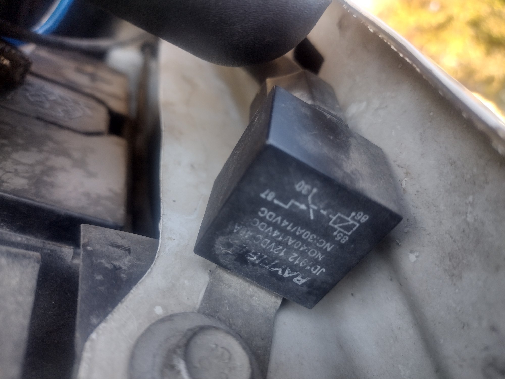

No power so there's been couple of questionable mods done on the truck has lights in the wheel wells. So is it normal for a relay to run only the right side cause there is a relay set up along the left fender I thought it was hooked up to the lights but I'm thinking it's for the right turn signal my hands bout froze solid before I went inside.
