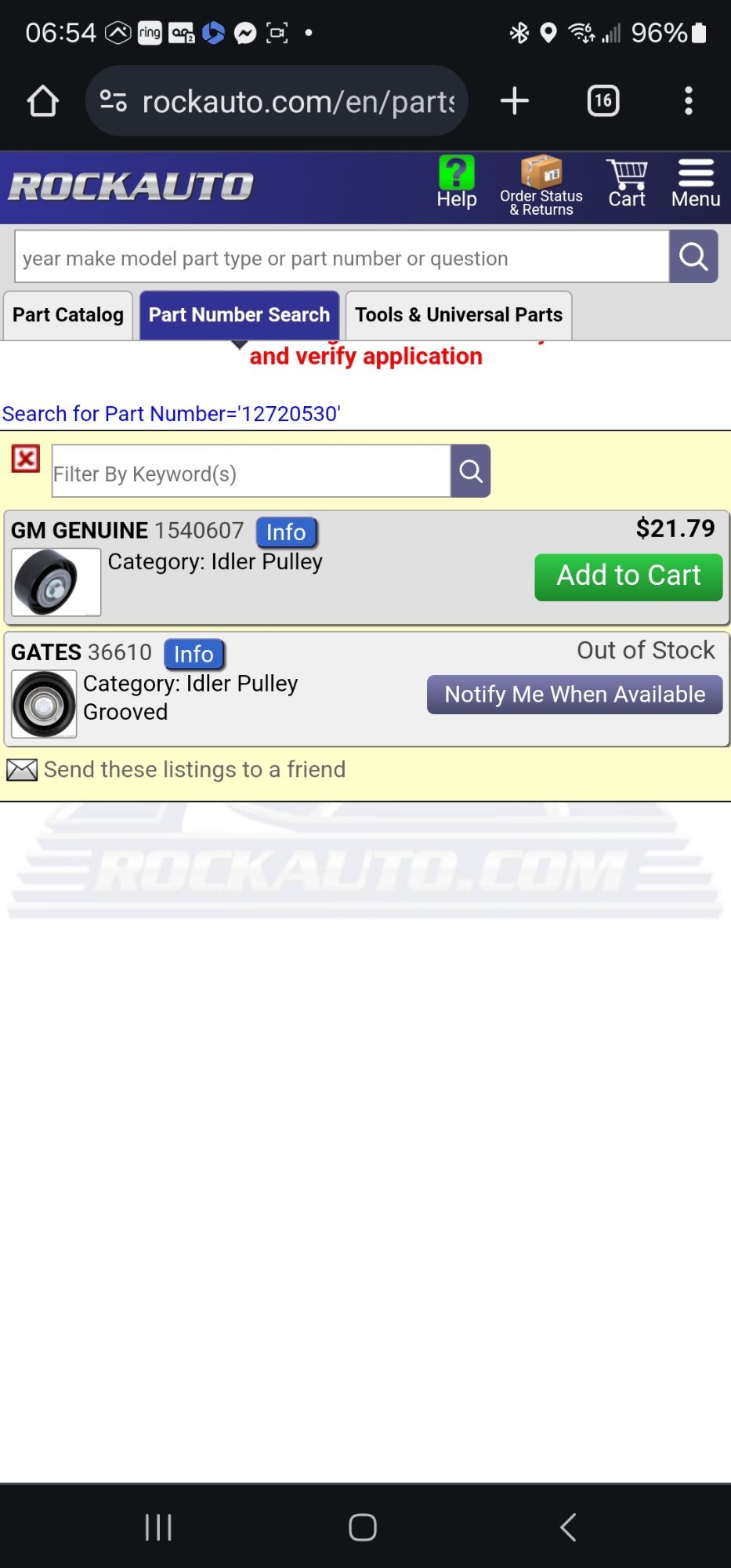

Check rock autoScreenshot_20240103_065407_Chrome.thumb.jpg.408b38449d4abb47b35c0bf02a08390f.jpg
Thank you! Image doesn’t match (smooth as opposed to grooved) but specs look good, and it does list the part number I need.  I’ll give it a shot!

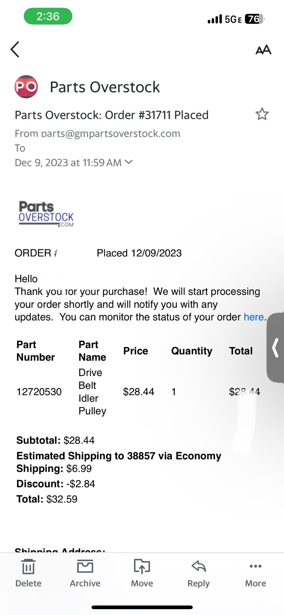

Same issue. Have to also look at newer part numbers that replaced the one that came on the vehicle. Replaced my OEM 55581830 with 12720530. Reused a washer from the factory one just to keep it the exact same…May have been ok without switching it. To remove the belt I just loosened the idler bolt and used a screw driver (any tool with smooth leverage would work) and turned the engine by hand clockwise. Always disconnect battery before doing this.

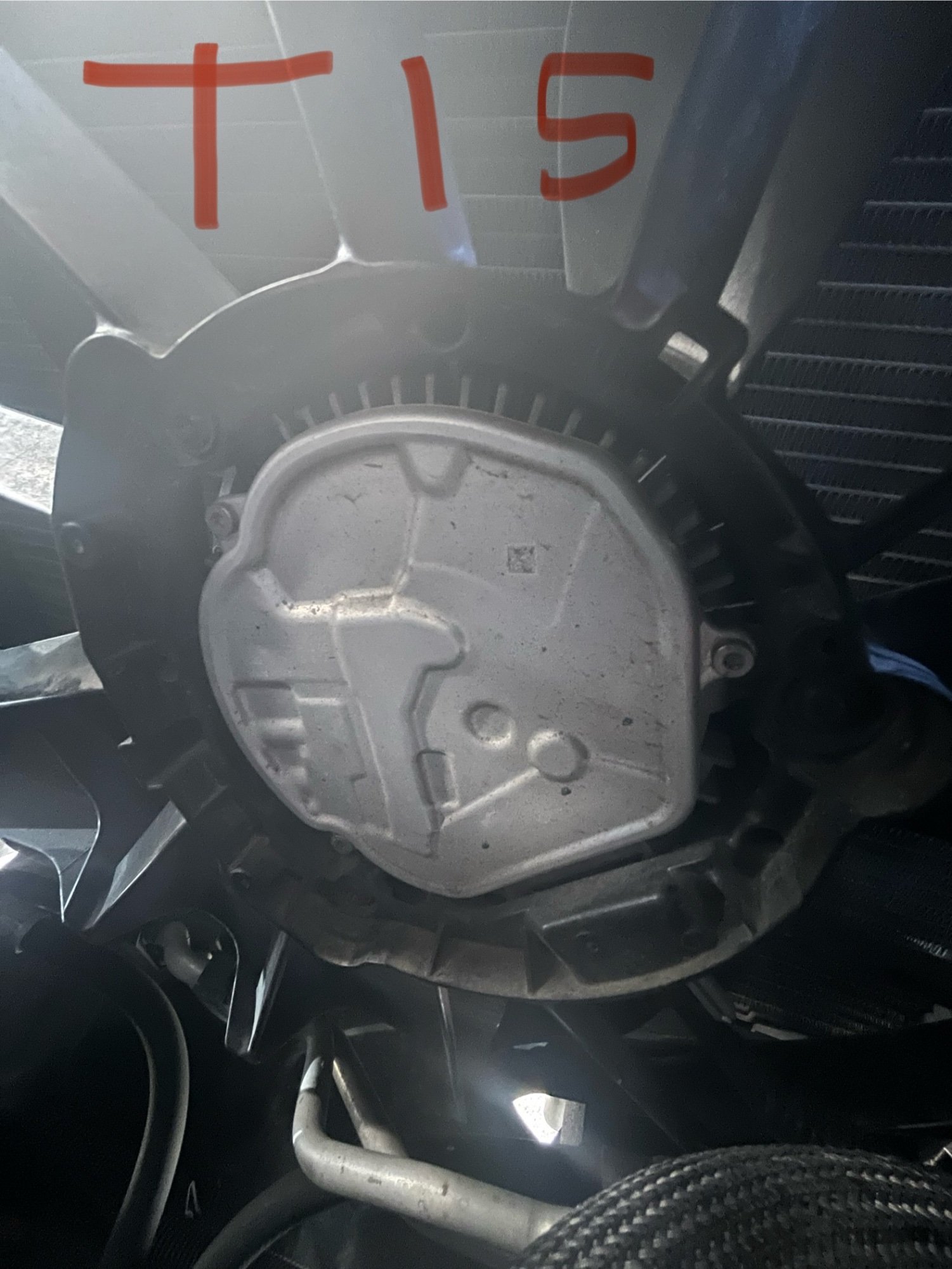

Also as extra insurance for some longer trips I have soon, I bought a used alternator from eBay from a crashed truck with 20k miles in great shape for $85 because I could not find any reasonable ones from GM. Normally I would just bring some extra brushes and regulator…but for under $100 bucks I am getting too old for that. Now changing the alternator requires a T15 to move the electric radiator fan out the way to.
