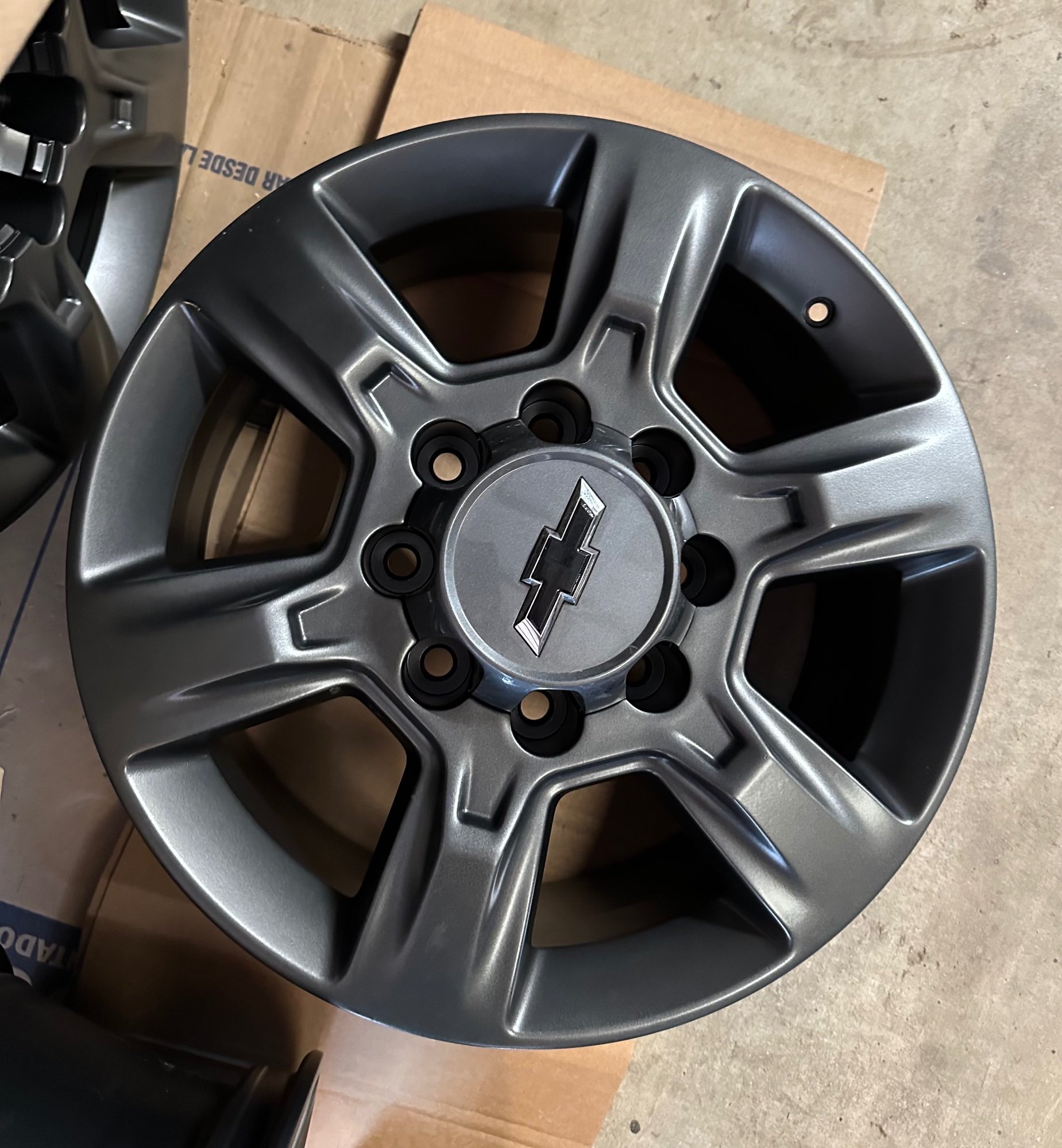

Sneak peak of the powder.  Can’t decide if I’m going to run the oem caps or get black caps.  The oem caps have kind of s blueish hue next to the wheel color.
