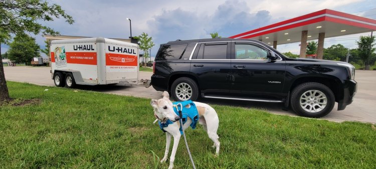

Questions - Now that both tow vehicle and trailer are loaded, should tire pressure be adjusted?  I checked the tire pressure on the trailer and it is now higher than the "Maximum" listed on the sidewall.  Also how do I compensate for temperature?  Say, I leave here 75 degrees Fahrenheit, and the temperature at the destination is 98 degrees Fahrenheit (realistic comparison!)
Also, for the tow vehicle, do I inflate tires to maximum PSI as tow vehicle is both loaded with a trailer attached as well?
Set the tires on the trailer to the pressure marked on the side of the trailer, cold, set the truck tires to the pressures on the door jamb cold as long as the load range and size is the same. If the load range has been changed go about 8 lbs below the sidewall pressure cold and as they heat up the pressures should be right around max inflation
Cold pressure and loaded i assume?
