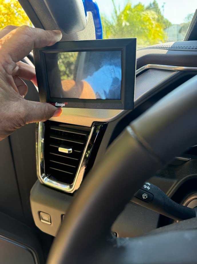

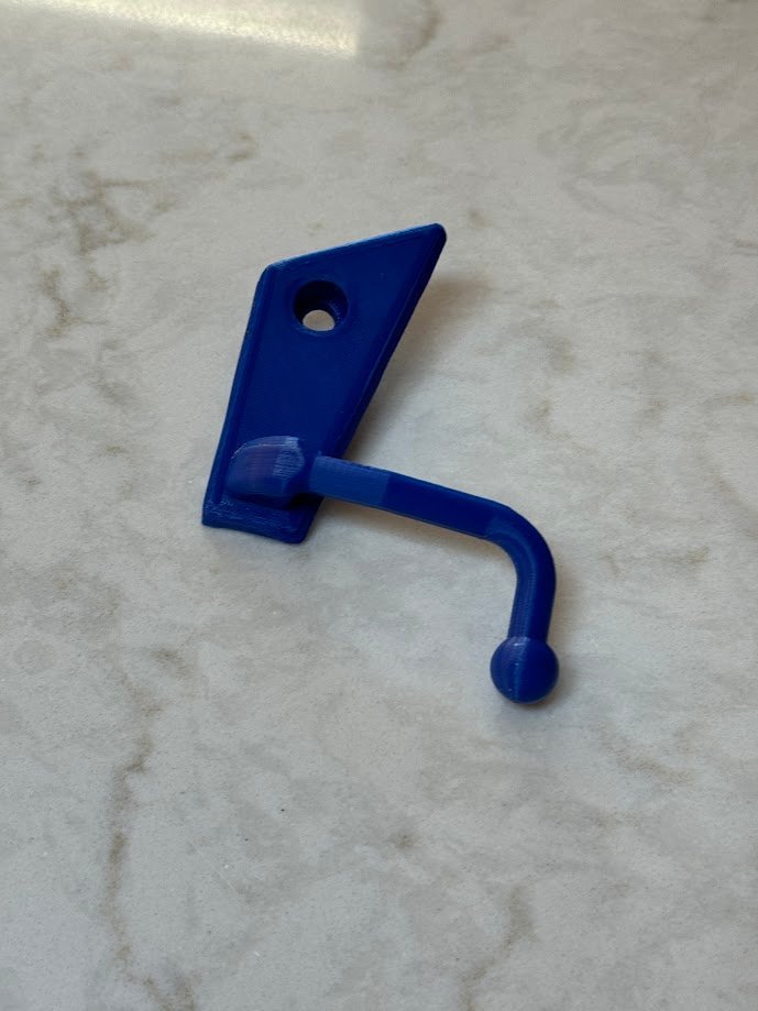

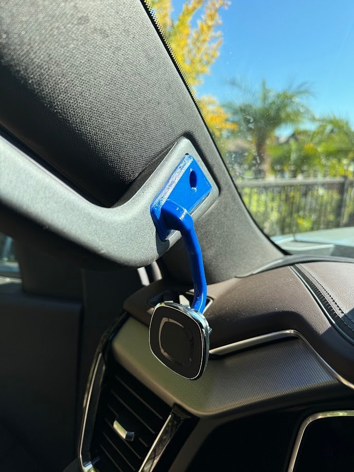

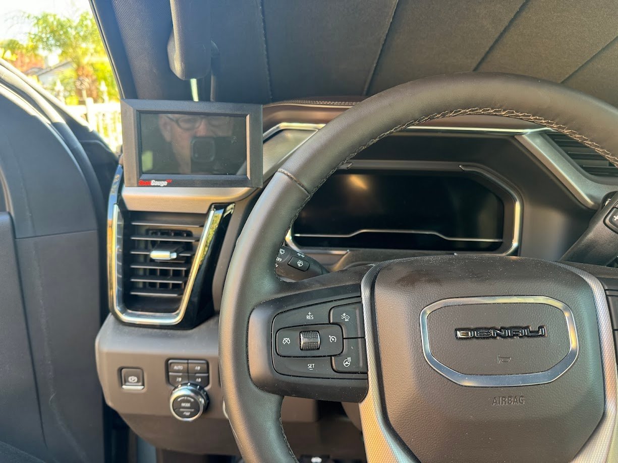

Done with my prototype printed blue for now. Next print will be black ASA material. Uses the ball mount portion from the magnetic mount that comes with the device.
Uses the bolt location that holds on the pull rail. Will be making a 3D printed plug to fill the bolt hole
