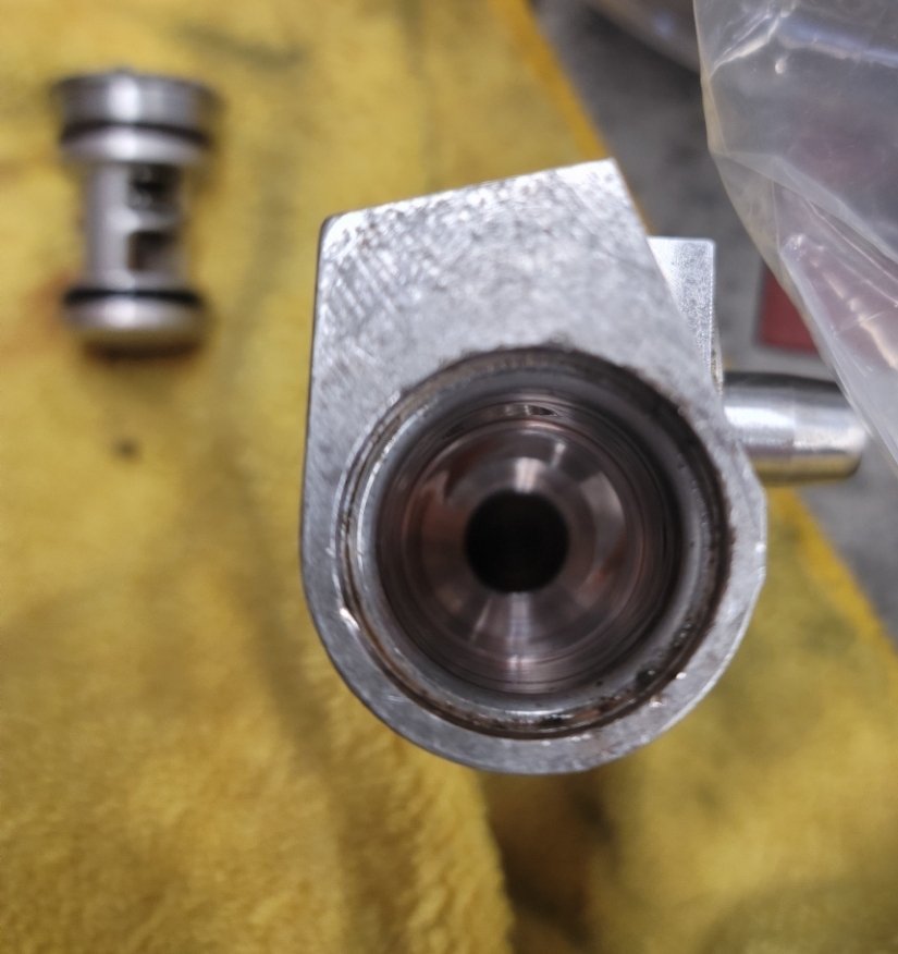

I purchased the Shift Technology thermal bypass modification kit and went to install it today but the existing bypass housing and internals don't match anything I can find.
When I dissassembled it, there was a pin in the center and a cylindrical piece that sits on top of the pin and resides up in the end cap permanently.
There is no passage between the two sides (plug both top holes and blow in it and air goes nowhere).
Is this already some sort of aftermarket bypass which would be permanently open?
- If so, why bother with the pin and cylendrical bit?
The transmission runs quite a bit warmer than I'd expect if it were fully bypassed.  I got this because I've already had the trans rebuilt once and a billet converter installed and I don't want to do it again.
What would you do?

I still have my original and opened it up. Yours is definitely different than a stock one. I already see yours is missing the "pill" and the spring. That pin goes inside the skinny part of the pill and protrudes from there. Here are the parts that are normally inside.
And here is a view inside the actual housing.
You can see the hole at bottom is much bigger. Also, with the guts removed, air is flowing freely through either tube on mine.

So I'm correct that with no passage between, it's essentially always allowing coolant to flow through the lines right?
Not sure about your statement "with no passage between".....I can't remember exactly how, but with the "pill" flipped, it allowed ATF to flow continually to the cooler. That's how these trucks used to work before the K2XX generation truck came along. Best way to know if it was allowing ATF to flow through was by the temperature of your ATF fluid on the dash display. If it stayed below the 150 F temp, for the post part, the bypass was working however the PO modified it. Hope that makes sense

In stock configuration, the spring is all the way inside hole at bottom first and the "pill" has fat end down towards the bottom and pin is inside the skinny part of "pill". For the mod, the pill goes in first with skinny part towards the bottom and the spring goes on top of the pill before putting top part back on.

Yeah.  Asking because the kit won't work with this housing.  I'll probably order a full aftermarket housing or the updated GM one.
So the pill is then sealing the internal passage.  It would stand to reason then that what I've got is a permanent block since there's no passage.
I think you're on the right track. These are easy enough to get to and swap out. The updated OEM one probably makes the most sense. And then you will still have the option of doing the pill flip later if you wish. I installed the updated one a few years back and then had a trans failure last spring that required a reman one installed. The thermal bypass valve from original trans got swapped over to the reman one. It seemed to run just a tad warmer than it did with the original trans so I did the pill flip. Temps are much more reasonable now.
