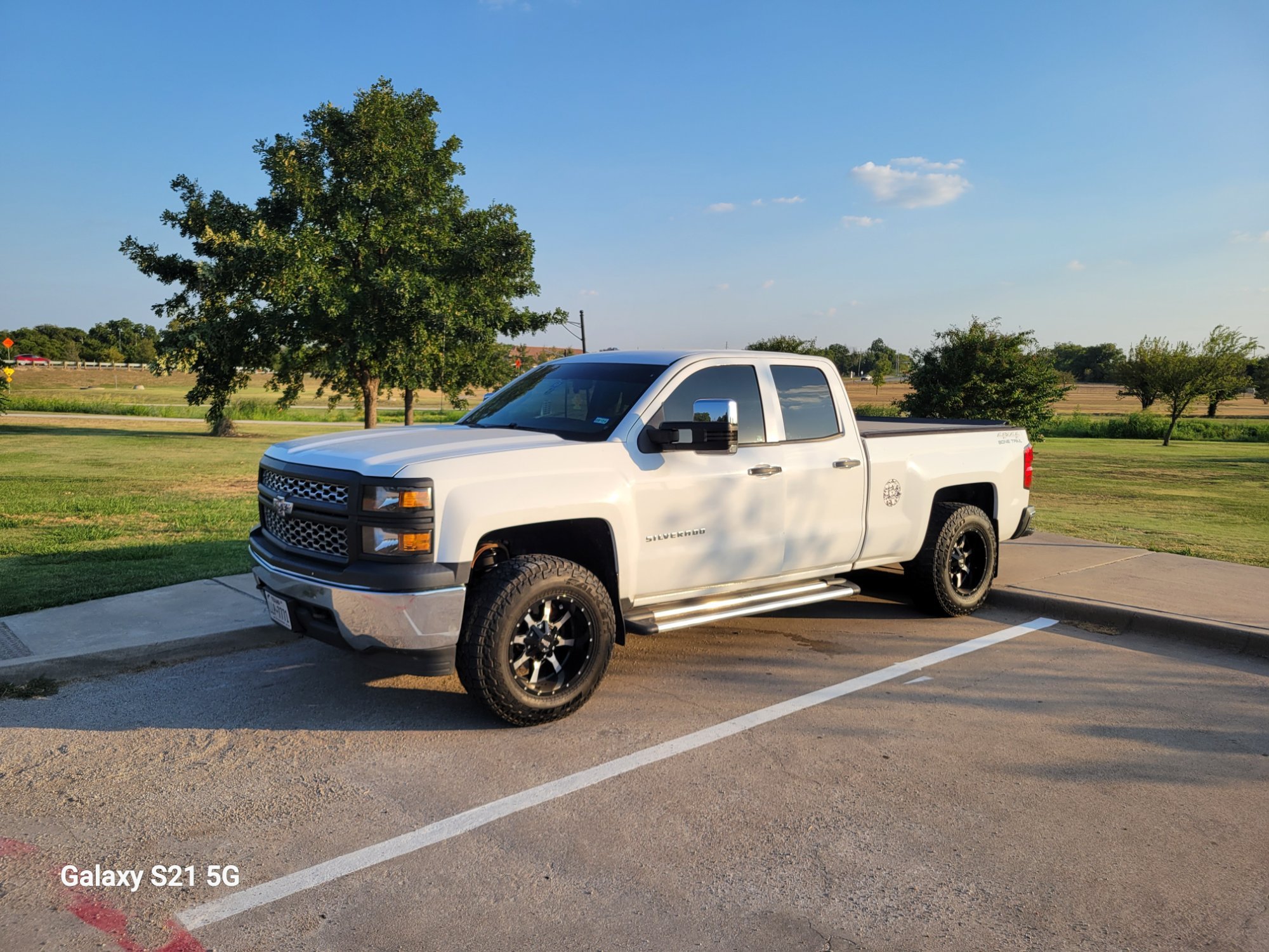

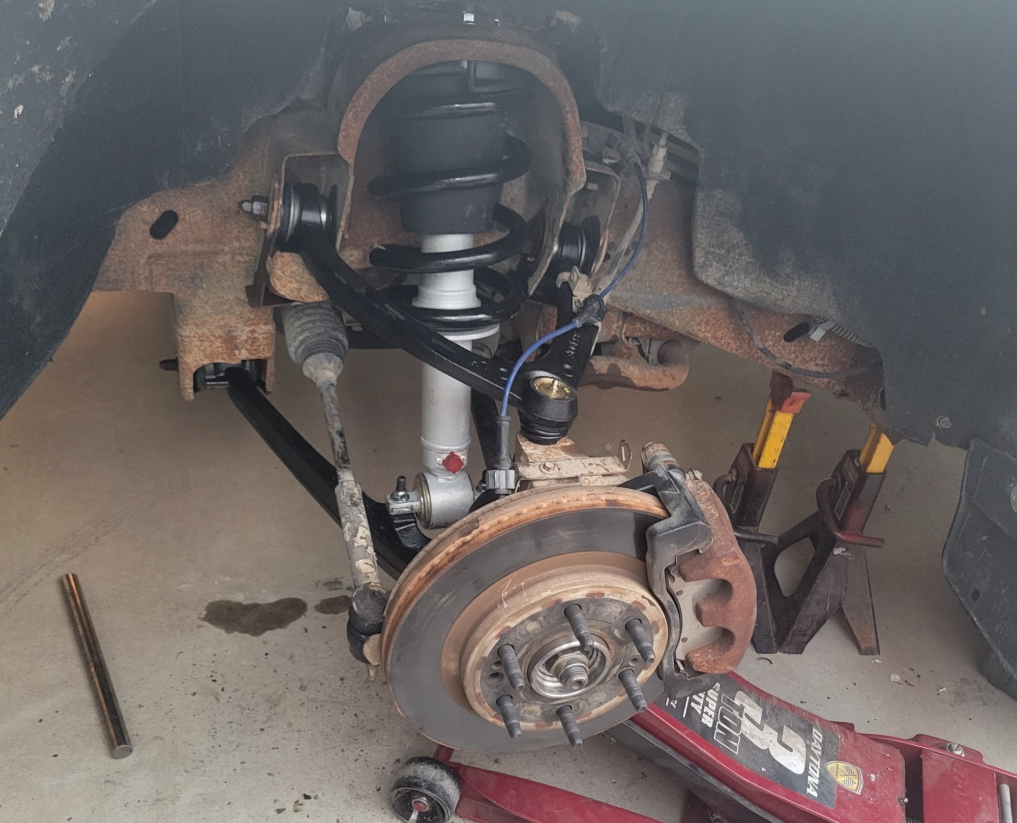

I have a '15 1/2T and put bilstein 5100s on full-lift about 20k miles ago.  I have e-rated tires and helper springs on the rear.  I love the height it sits at and the helper springs are necessary for my camper.
I'm wondering if there's something that could give me a similar ride-height, but have a softer ride.  It's really harsh right now and I'm getting kind of tired of it.  I'm considering going back to d-rated tires with the next set, but they're only half worn right now.
Is there a smaller (3" or less) lift that I could replace the bilsteins (or even better, reuse them on a standard height) that would ride more like it did before I modified it?  I don't want crazy height or big tires.
Rancho quick lift FTW. Night and day in terms of comfort. You will need 2" blocks in the rear to level the truck after.
