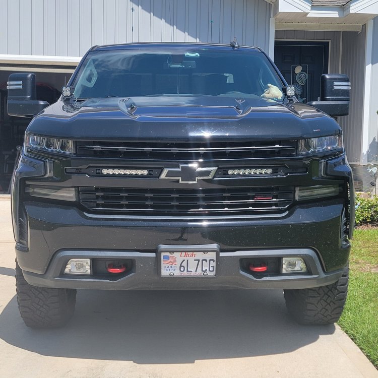

Baja Designs 10" S8 lights replacing the lights in the Rough Country dual grill lights kit.  I just needed to get off my rear and do a bit more trimming of the grill.  Baja Designs lights are slightly narrower, but much thicker than the lights that came with the Rough Country kit.  I used rubber bushings to compensate for the difference.  The mounting bolts supplied by Baja Designs were a little shorter than what I needed, so I got longer bolts at Lowe's.  There was a slight mounting issue with the Rough Country brackets.  The brackets closest to the bowtie had a spacing issue with the light bar mounting bolts, so I ended up turning the bracket around and threading the light bar bolts through the mounting bracket and walked the bracket while tightening the bolt until the bolt that connects the plate on the exterior of the grille and the bracket could go through both.  I think this was a more secure mounting method anyways.  There is no interference with active aero shutters.  Wired directly to GM Upfitter switches.  Iirc, each light bar produces about 4,000 lumens.  That's a lot brighter than the Rough Country light bars that are no brighter than the OE high beams.

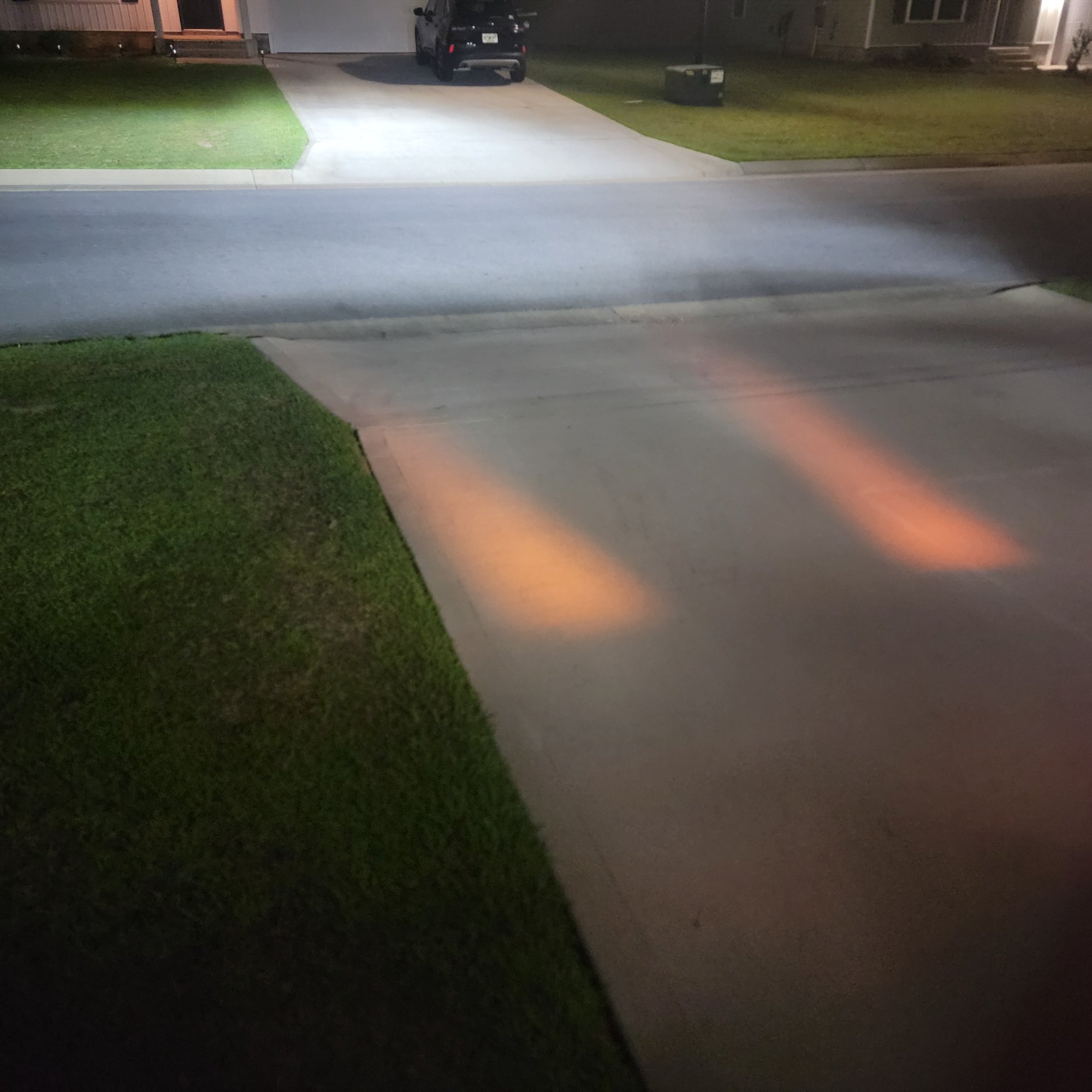

Just took some nighttime pics with the new lights.  Sorry they are crappy cell phone pics.  Imo, this turned out better than I thought it would.  I used an add-a-fuse kit from Baja Designs and utilized fuse location 42 in the fuse block under the hood.  I didn't realize the amber lights were projecting due to not seeing them on the roadway while driving.  I'm truly surprised these amber lights are as bright as they are.  Website photos from Baja Designs makes them look more subdued than they actually are.  Imo, these amber lights are brighter than all amber LEDs lots used to have the Raptor look that I've seen on Tacomas and Silverados.  I also need to adjust the light bars and aim them slightly upward.  The white light is aimed downward, but not too badly.  The last pic is with the low beams on.  I am debating about whether or not too change the fuse location for the amber lights so they illuminate while driving during the daytime.

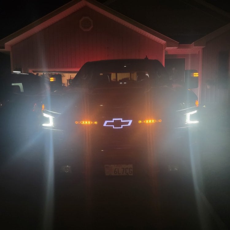

A few more pics with the lightbar lights on.  From the side you can see the amber lights are still on, but they are being washed out by the white LEDs.  From straight on you can't see the amber lights at all.

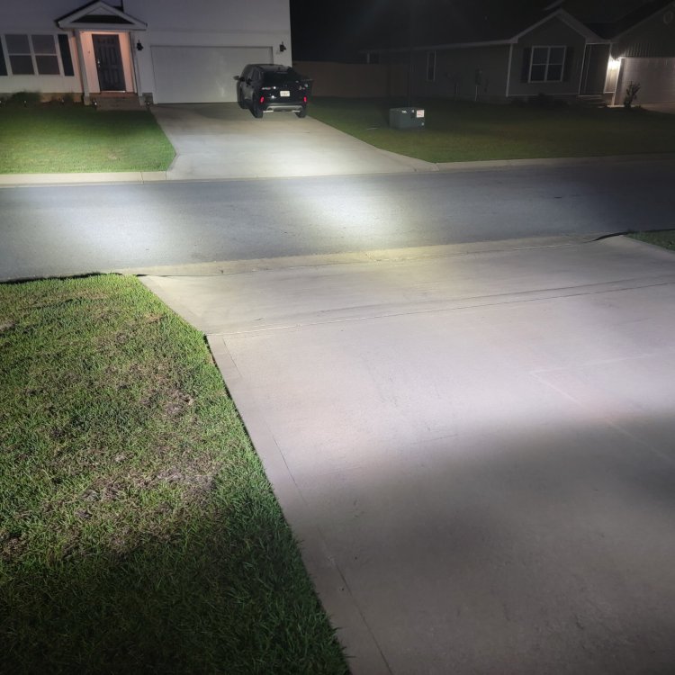

One last one with the low beams.  Btw, my driveway is sloped.  Please don't judge the distance of the lights in these pics.

Update:  I pulled the grill again and re-aimed the light bars.  This was easy.  I didn't need to remove the grill completely.  I just needed to pull it away at the top far enough that I could reach behind the grill.  I then grabbed the light bar angle pushed the back end down so I could aim the lights a little more upward.
I also decided to switch the fuse location from #42 to #40.  This was solely so I could have the amber backlights illuminated during the daytime.  They are bright enough to be seen.  I'll try to grab a Pic and post it later.  I had a busy day that bled into the evening and had me late for my oldest son's birthday dinner.  So, please forgive the omission of the pic.
