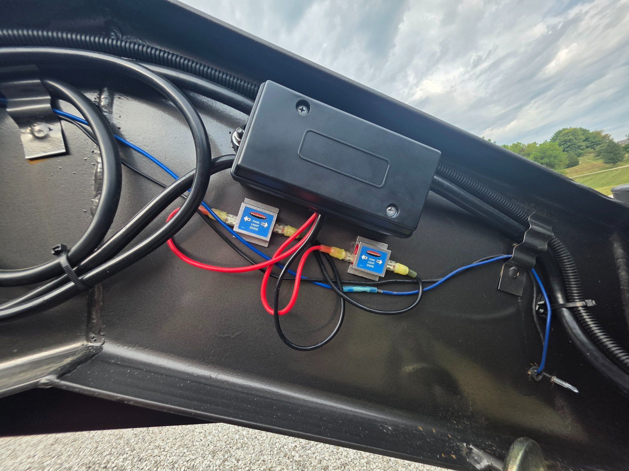

I installed the Hydrostar module on the brake wire (blue) and prepped the 12v+ wire module in case it needs it. Hydrostar said I may or may not need the module on the 12v+ between the truck and trailer.
