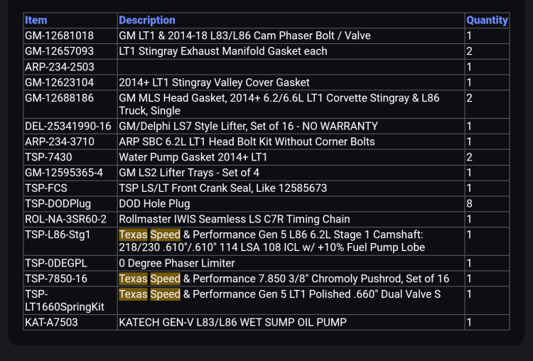

Anyway, everything was torn down to the block. Lifters replaced, new cam, new oil pump to be safe (parts list attached). There was no visible metal but I wanted to be sure. I also had it tuned because of the DOD delete, etc.
