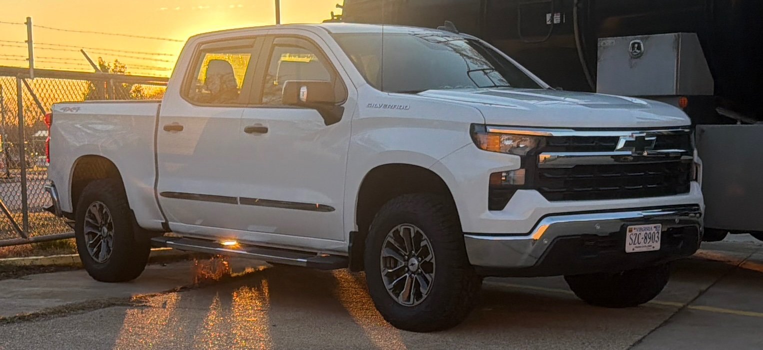

Hey boss, just wanted you know I recently did this with my 2024 w/t 1500. If you use a 1” shackle in the rear with trail boss struts up front, it sits level. I’ll send comparison photos. Also keep in mind, I went from 255/70R17 tires to a new set of wheels and 275/70R18’s to match the ZR2.
the factory ranchos are super spongy and a lot like the shocks that came on the Silverados that didn’t have special packages. I had a set that wore out completely at 25,000 miles. Skip the ranchos and get the Bilsteins. You’ll save money and get a better, longer lasting product.
the 2” lift also comes with CV axles. YOU DO NOT NEED THESE if and ONLY IF you are just going with the 2” lift. If you go any higher in the front, you need the CV’s AND upgraded upper control arms.
PLEASE keep in mind, I swapped the grille, added the side step bars, rear fender liners, removed the air deflector on the bottom of the front bumper, and downgraded license plates to avoid paying the government more money than they absolutely have to have…..but I promise it’s the same truck. There is more than a year’s difference between these two photos.
Edited by s10dragracer888

I used a 1” shackle with urethane bushings and grease fittings for a level look. I love it. The new Falken Wildpeaks ride better than the duratracs I had on the last one from factory.
