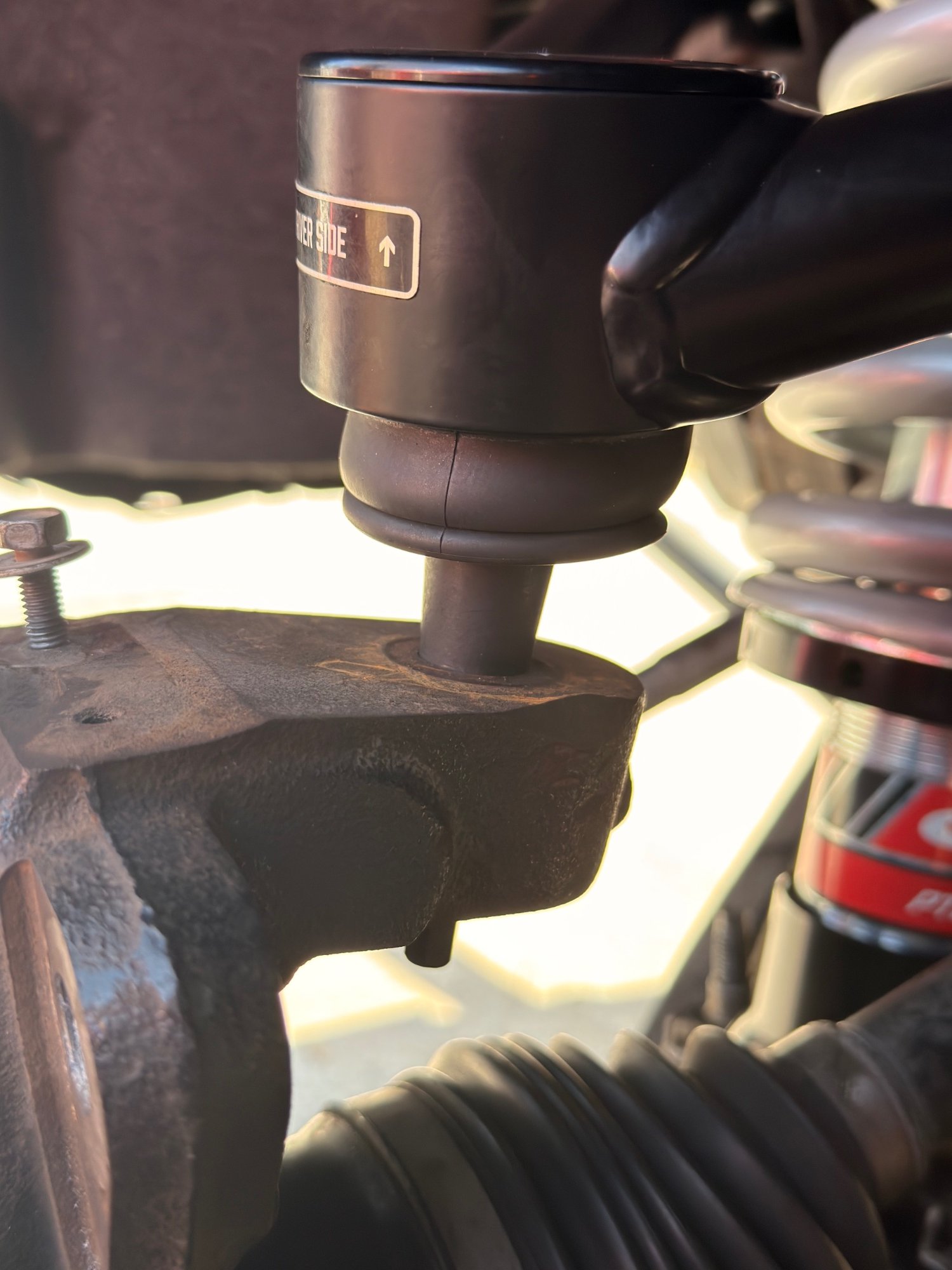

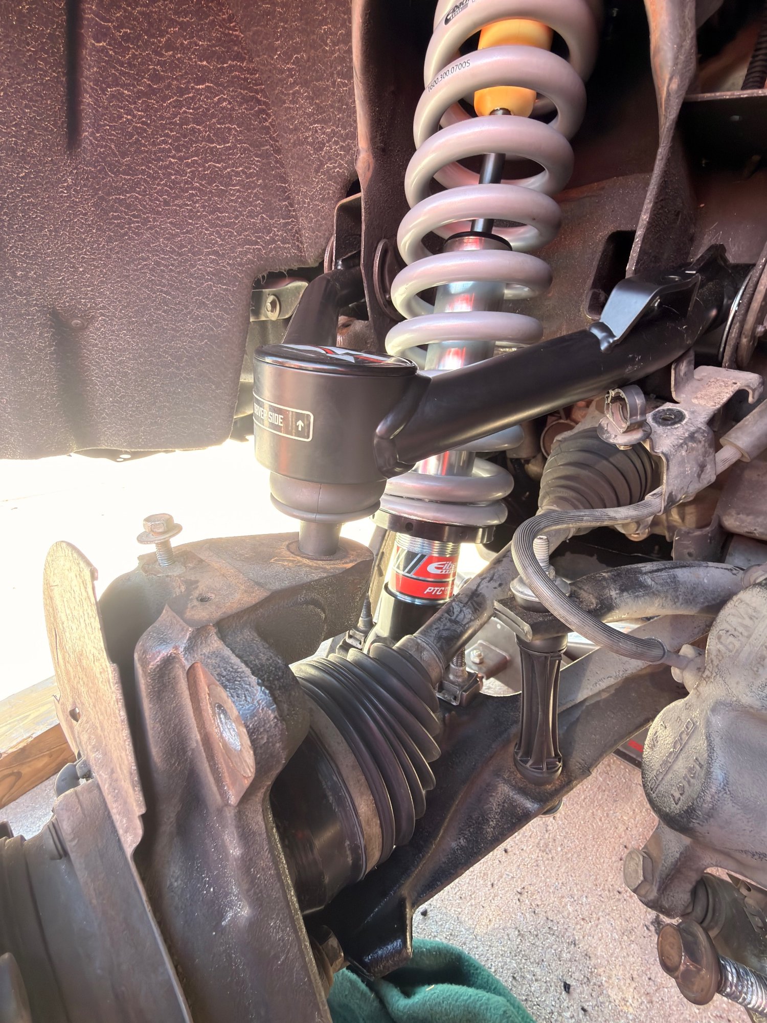

Hey so I ordered these UCA’s for my 2015 Chevy Silverado LTZ for ready lift which they said will work with my model but the ball joint won’t fit down into the knuckle any suggestions?
So either you ordered the wrong UCAs or the company sent the wrong ones. I would contact the company and see if they can send you the correct UCAs or replacement ball joints that can be pressed in.
What UCAs did you buy?
Sounds like you had the forged arms and not aluminum or stamped.  The stamped and aluminum arms have a larger ball joint stud than the forged arms.
Judging by your lower control arms, you originally were built with the forged arms.  You need replacement arms for forged arm trucks.
You have the wrong arms.
