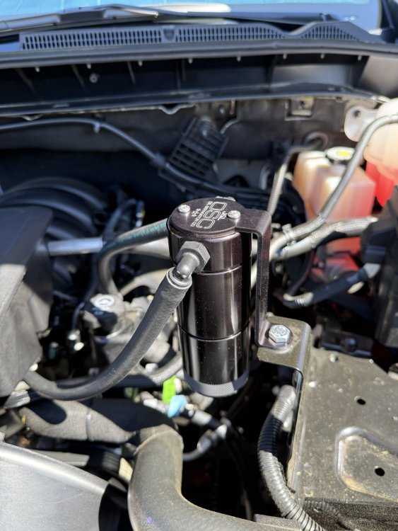

Catch can added last night. Will add pics later.
Edited by GAMark
On 5/13/2026 at 6:26 AM, GAMark said:
Catch can add last night . Will add pics later.
I have about 15k miles on my install definitely catches fuel/ oil burpup
