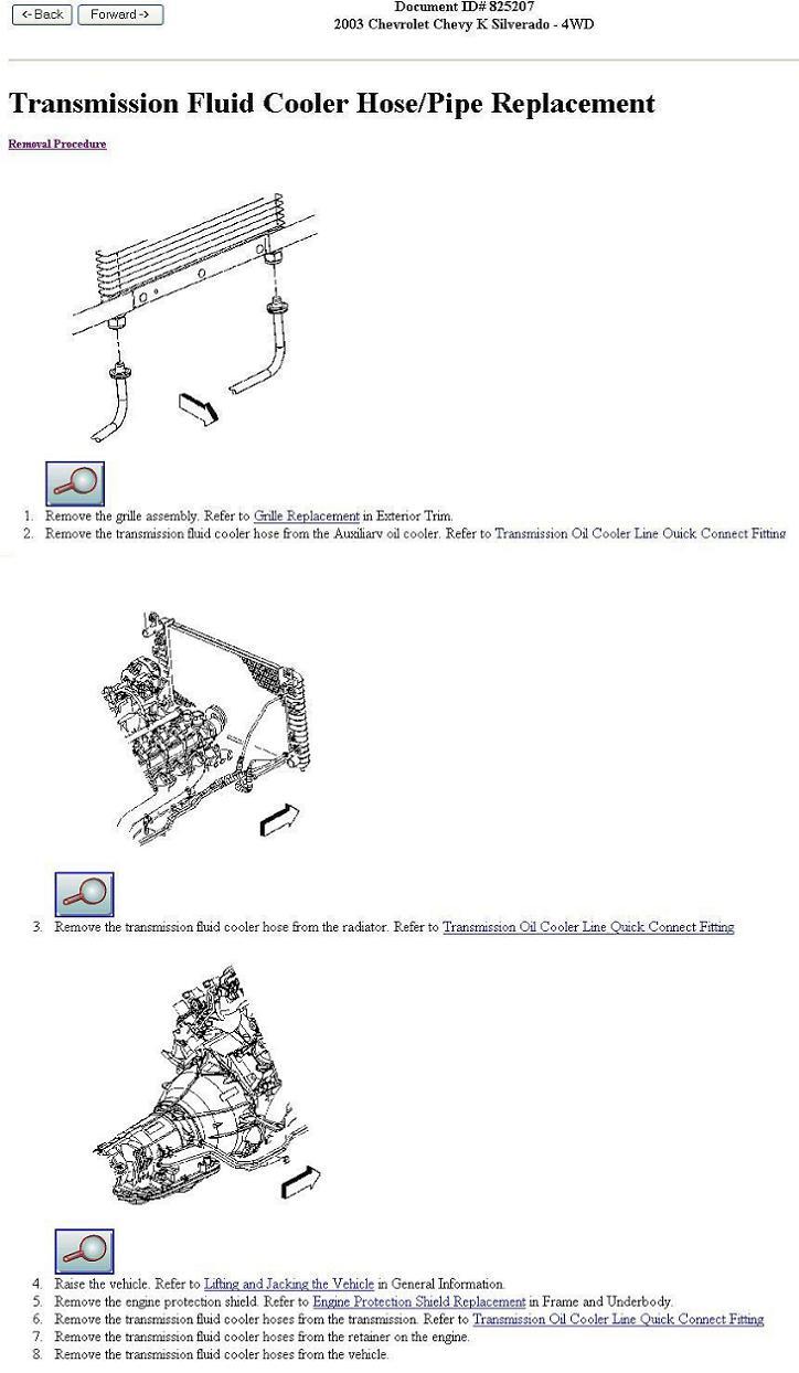

i took a look this afternoon and here is what i see......not a whole lot of room!..LOL
In this order from engine to grill i have:
1. radiator
2. a/c condensor
3. some sort of cooler...its about 10"x14"
4. another very small external cooler on the right side of the radiator running verticaly...its about 3" wide and 12" long
I thought the 10"x14" cooler was the oil cooler but i saw the radiator has lines running into both sides which i assume are trany and engine oil. What are those other coolers out in front of the condensor for?
I will try and get a few pics if your not sure what im talkin about.
One will be power steering, I'm not sure about the other.
Vernon
Okay, the small on the right is power steering like you said. The other one, as wierd as it seems is also a tranny cooler. Looks like there are two trany coolers on these trucks, a primary and and auxilary. I have not looked to see how its plumbed up yet, but it seems odd. I checked this on my ESi manual, can you check your shop manuals and confirm this?
