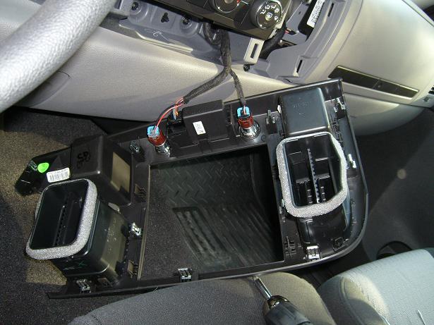

Hi, I'm new to the forums and I saw some people questioning how to remove the dash. It's actually rather easy and doesn't require tools. Be careful with the plastic but gently pull from the top until the clips come out and work your way around the plastic. I have also included a couple of pictures to show you.
Thanks for the pics, very helpfull !!
