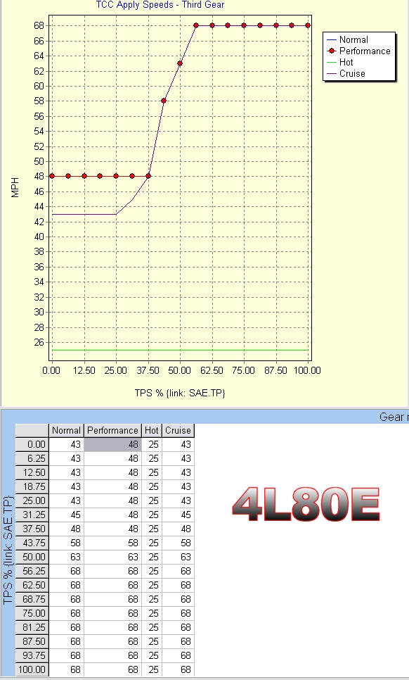

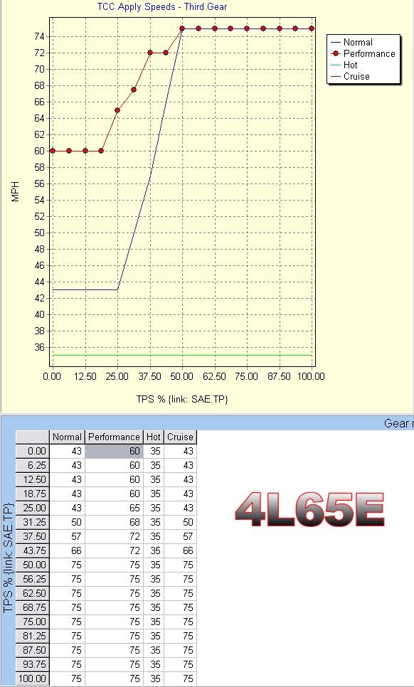

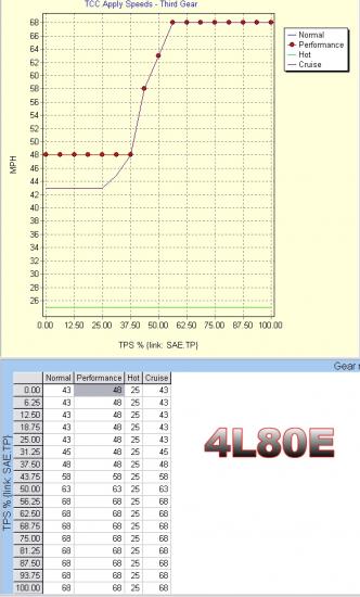

BTW, does the torque converter lock-up in OD only, or does it also in 3rd?
