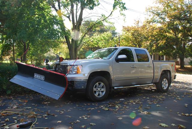

Just Install My New Plow
Nice plow. I'm looking for one for my silverado. Did they have to cut your lower valance, to mount the frame? I'm looking at either a fisher or western. What made you decide in the hinniker?
I did not have to cut the valance , I only have to take off the small airdam
and use a license plate adapter, BOTH western and Fisher require you to hack up your plastic section of bumper. I can email the install manual for those. what I really like is the cross member comes right off in the spring 4 bolts and my airdam goes back on. I will do the switch over everyspring along with my 20" wheels going back on, I kinda like the new lic plate mount its flush.
PM me if your intersted I can get one complete for less the 3200 shipped tom a loading dock, the guy was really nice that I dealt with ,I also avoided tax.
another reason I choose this brand is the pump is the ame one they use on the bigger plows up to 8feet the hyd cylinders are full size. also the 2 homeowner plows from fisher and western are short like 20 inches this is 26 which looks like a full sized plow. "well almost"

nope, its a homeowner "non Commercial plow 448lbs" and not over the GVRW for the front axle, I even provided its own battery with a circuit breaker to the factory system.
I can have the frame and harness off in a hour with an impact if need be.
however if burn up the transmission " its gets hot and I say F**k it I got a warranty" or crack the frame beating the snot out of it " smashing into hugh snowbanks" well then Im screwed.
