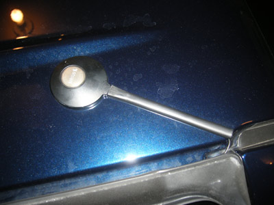

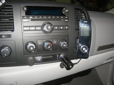

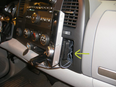

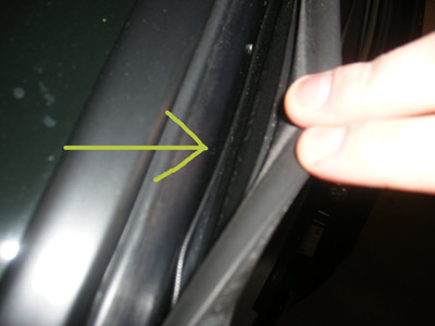

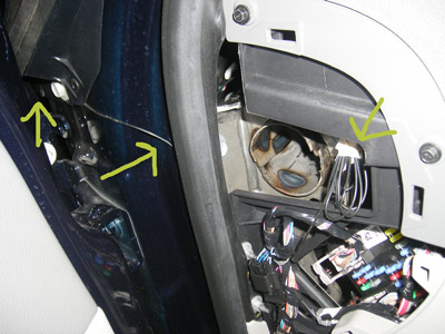

I've had the S50 for over 2 years now and love it. Just bought an 07' Sierra. Installed an after market bracket in the open space just under the air vent to the right of the radio. Ran the antenna wire into the console underneith the radio, through the glove box and then back underneith the entire dash, under the steering wheel and then up into the fuse box area. Then under the door molding, up to the outer molding.. then to the rear of the cab to the roof. It looks great! and works great! I'll see about getting some pictures posted soon..
