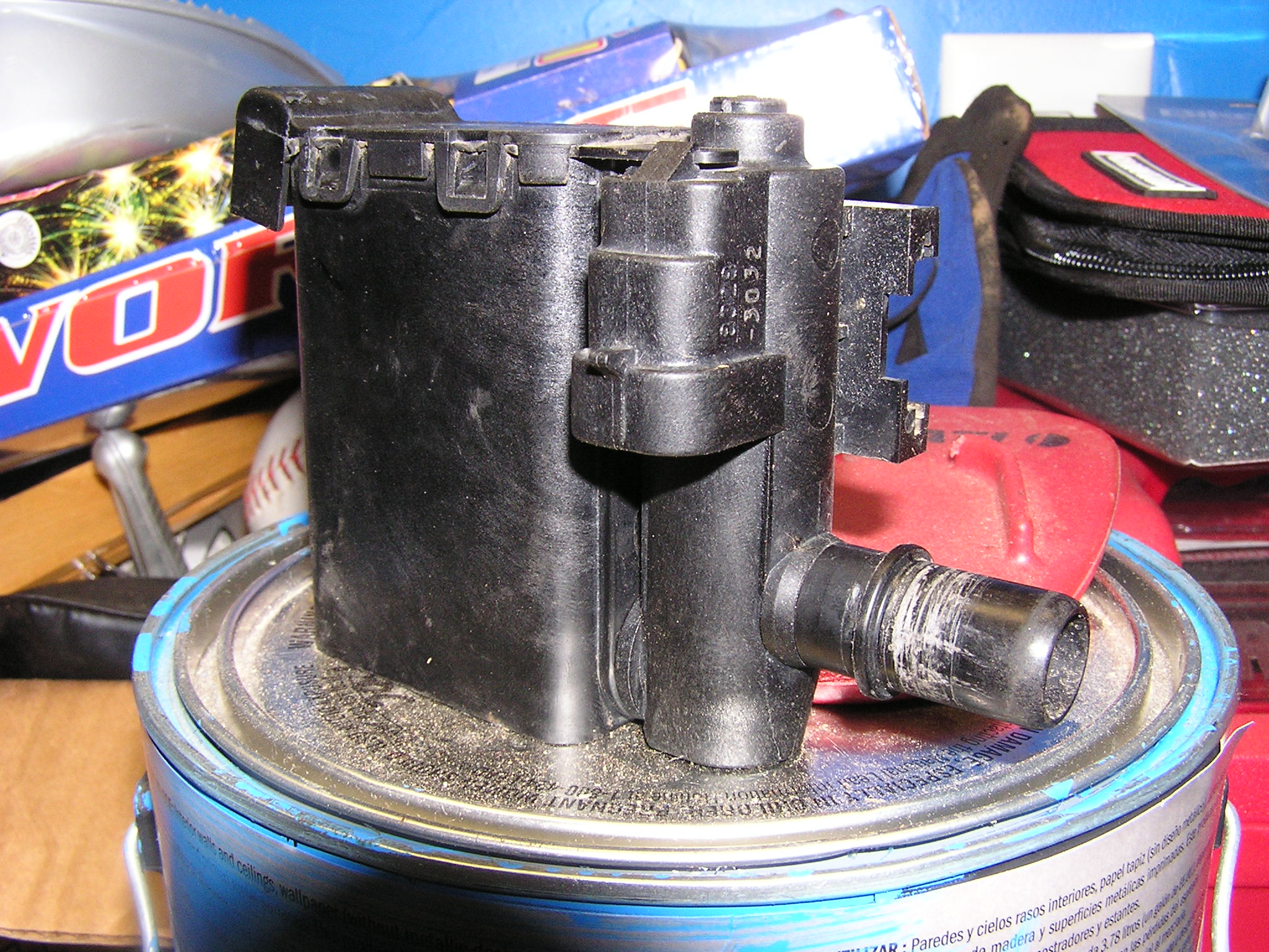

Ok guys, hopefully someone can help me out...... I got the evap vent solenoid off my 2003. It is dead. Can someone point me the replacement part? As I stated before, this is not the round one found on the 2004 and up trucks? I am hoping its the 214-1105. Or is there a gm number for this part that is not the relocator kit for 200.00? Mine looks like this.....post-81176-1285114351_thumb.jpg

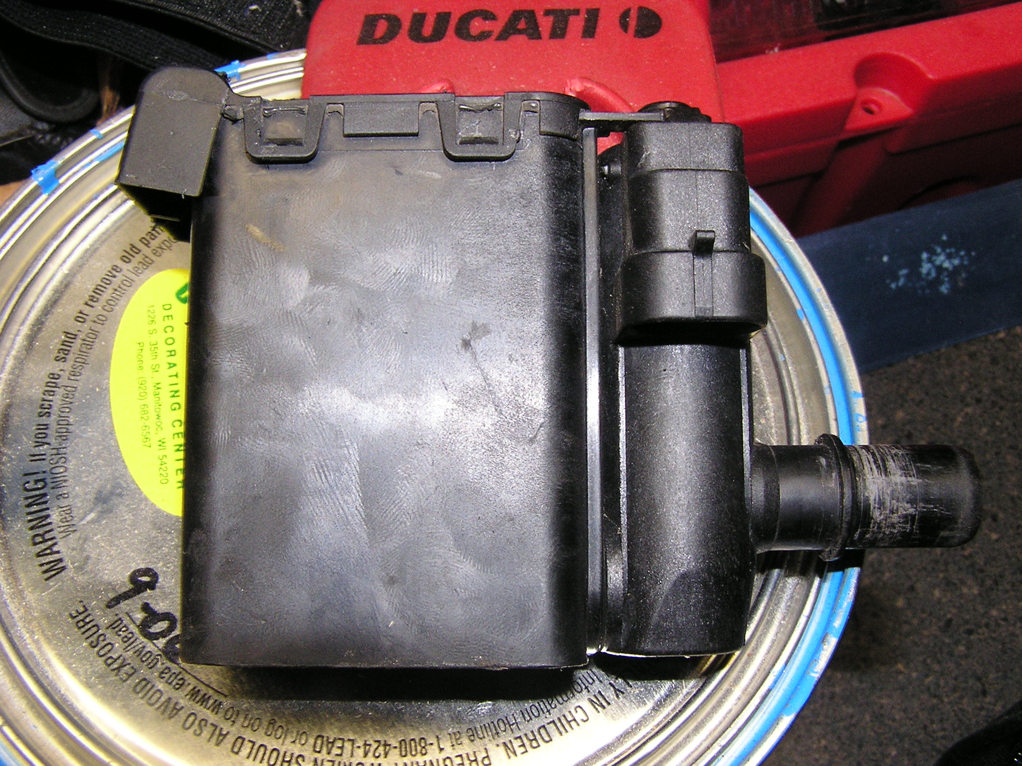

Here is another pic of the part off of my 2003.......
take that old evap. solenoid to a gm dealer or auto zone or advance auto and buy it and put it on.. you dont need a part number.

I was hoping to get a part number from the ac delco unit that I could get at Advance auto. The problem is that all the Advance auto's around here don't stock many of these parts. I would have to order it, so I was hoping to get the right part the first time around. Thanks again to all!!

take your old part to gm. and they will have the new one. mine cost $30.00 included tax. advance and ayto zone would have had to order the part,

Did just take it over there and they matched it. Put it in last night, light went off on my ride to work this morning. Thanks again to all that hleped.

Did anyone ever get a part number for the one pictured. I also have a 2003 but don't want to pay the high price. Mine looks like the one pictured here. Not the round one Thanks.

I just changed mine for Tahoe 2003, and as per our dealer the box shaped one is not available anymore, I replaced it with the rounded one (GM 25932571 AC 214-2149),
instead of the box shaped GM 10382105 AC 214-1078).
