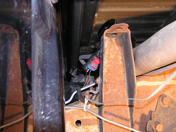

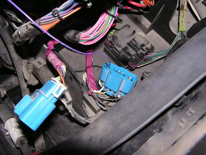

Thanks to everyone's information here, I tried replacing the vent valve on my 2000 Sierra deviating from what Rock Auto tells me to get (the expensive kit). I bought the round valve, part 214-2149 for $35 including shipping from Rock Auto. It didn't match the square valve on my truck, but the wiring connector and the vent hose connector matched. I plugged it in, took off the bracket and just left it sitting in place. It doesn't look like it will go anywhere. I could barely get it in there. But this didn't turn off my CEL or get rid of my P0449 code.
I saw Maxoutput's note about a broken wire, so I started looking for that. First I checked that I had 12V at the IGN1 fuse in the fuse box with the key turned to run. I did. Then I checked for 12V at the plug (on the pink lead side) - still good. Then I pulled the ECU and the connector blocks and tried to find where the ground (white) wire went. I found a likely candidate, but I didn't have continuity between it and the plug. So I traced it into the bottom of the fuse box, separated the connector there and tried again. No luck to the connector, but I had continuity from the connector in the fuse block back to the ECU connector. I didn't see anything bad looking in the engine bay, so I raised up the bed a bit (which was a huge pain due to my hitch being in the way of the last two bolts on the bed) and took a closer look at the connector for the valve. The wires were all wrapped up in electrical tape right by the connector. I undid that and found that the white wire was cleanly broken. I checked continuity between the break and the connector in the fuse box, and that was good so I proceeded to solder the wires by together, heatshrink the connection and put a plastic wire loom over the wires. Plugged it all together, put everything back together and it worked! No more CEL.
I attached some pictures showing the white wire and connector under the fuse box that connects to the vent valve. It's the blue connector that's pulled apart, the white wire on the left end that has the purple wire stuck into it (which is connected to my ohm meter). The other pic shows the connector with the repaired white wire (the vent valve is twisted out of the way while I was soldering the wire). Hope this helps someone.
