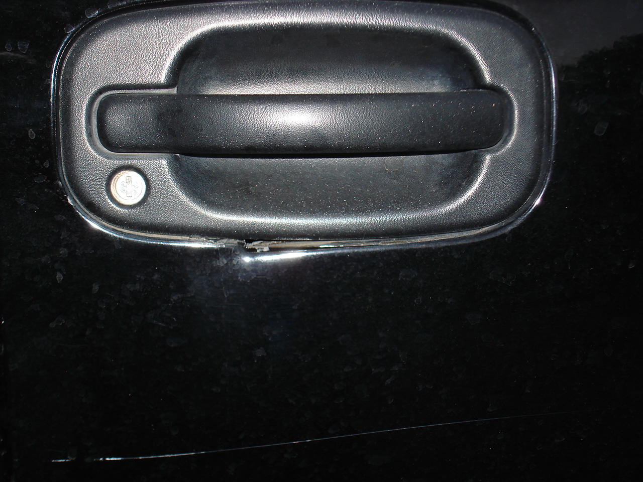

During a usual week, there is at least one break in/ vandalism every other night. Unfortunately, the cops won't patrol this neighborhood because no one speeds so they can't make any money. My truck was hit again about 2 weeks ago (I've been busy). This time they stuck a screwdriver between the door handle and the door and popped the lock. Luckily, the alarm went off as soon as the door was opened so nothing was stolen. But now there is a hole on the door to let every thief know that my truck is wide open. It could be worse- my neighbor's truck was completely emptied out, including his 2-week old GPS unit and his back window was smashed in. Waking up 3 hours early is not the way to start off your graduation day. I'm sick of this, everything has been done to my truck minus it being completely stolen- egged, painted, keyed, etc. Anyway, here are some pics of the door (don't mind the key scratch-that was a previous vandalism).
If anyone has any cheap and easy ways to fix the door, let me know.

Try taking off the door handle, take pliers/vise grips, to the bent edge, tap with a small hammer, and try to form it back. The paint may crack and flake on you, but it's worth a try. The metal on these trucks are thin. As for some preventive measures, get a camera, that overlooks, your vehicles at night. Do a search for wisecomm oc-960. This camera has color and audio, 100 ft. cord, and connects to a VCR inputs. Get a 8 Hr. tape, put it on slp/ep mode play, and record at 9 pm. every night. Look your vehicles over good, every morning. At least, you will have the "punks face" on tape, and may know who it is! Also search Clover oc-960 $42., this is the same camera as the Wisecomm oc-960. If you live in the country, you can put up "deer motion sensors" and be alerted to movement outside. On the door handles, I installed "crew cab rear door handles" on my front doors, and did away with the keyholes. I also bought the autoguard hood latch protector at http://www.trucksecurity.com The hood latch is cheaper at http://www.autoguard.us for $39.95. Also, I have an aftermarket alarm, with ignition kill and a bright LED on the dash, in plain view, of both doors. Also, have a outdoor light sensor, over the camera, with 75 watt flood lights, pointed at your cars, so the camera will see better at night. It is up to us, to take care, of detouring theft, as much as possible, so I hope this will help you and others out, to protect your trucks.
