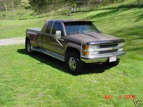

Beautiful truck Hawghauler! You should create a new member thread and post more pictures! Welcome to the site!
