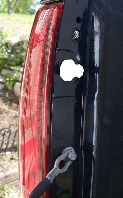

tcracing425ex Posted October 27, 2008 Author Posted October 27, 2008 i have no clue what that is, any pics or anyway to explain where it is?
jrrod2004 Posted October 27, 2008 Posted October 27, 2008 i have no clue what that is, any pics or anyway to explain where it is? Download the file for the animation:
jrrod2004 Posted October 27, 2008 Posted October 27, 2008 sometimes that can cause the gate to 'seize' up when the lock does not 'catch; on the striker properly.
tcracing425ex Posted October 27, 2008 Author Posted October 27, 2008 that piece looks fine. how do i know if thats the issue or not?
