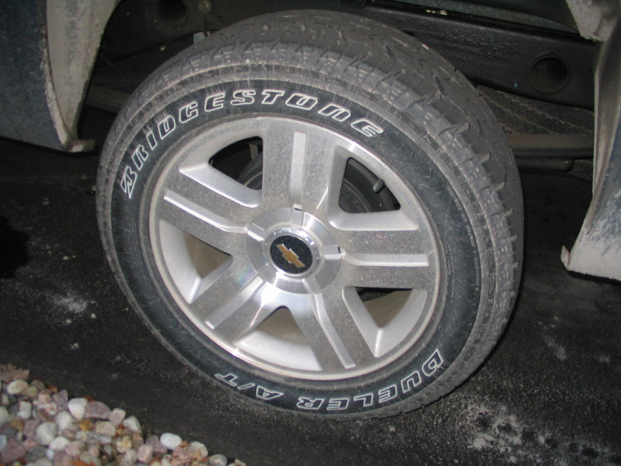

I have a set of Bridgestone Dueler AT Revos size 275/55/20 on my 08 Silverado and they do just fine, both on and off road. It really depends on what you mean by dirt action. If you are doing the odd gravel road with some bumps, my experience is that the 20s handle this no problem. If you are going through rocks where there will be constant opportunities for wheel articulation, you may get your rims scrapped and might better off with a smaller wheel. The new Chevys have Independent Front Suspension which work well on roads. In fact, if GM were really serious about off road capabilities for trucks, they would still make them with double axles, like a Ford 250, Ram 2500, or Jeep YJ for that matter. GM made the switch from two axles (front and back) back in the early 1990s when they realized most truck drivers did not take their vehicles off road. Nevertheless, I have taken my 20s through some pretty rough stuff and they stack up compared to the BF Goodrich TA KOs 16s I had on my old Dodge. They have handled dips, bumps, ruts, and instability in general etc just fine. I use the truck for normal use, and am an avid hunter, fisherman and camper. The 20 inch revos have handled all of these situations. When compared to my earlier 4x4 experiences, I found the 20s to actually be quite stable and distributed the weight of the vehicle a lot nicer. Again, there are pros and cons to each wheel choice [as most guys on this site will tell you] but you really need to assess your requirements and match them to the driving conditions while considering price. Oh ya, the pic provided shows that I do actually get mud on my tires - proves I didnt buy my truck to get groceries or soccer dad.
