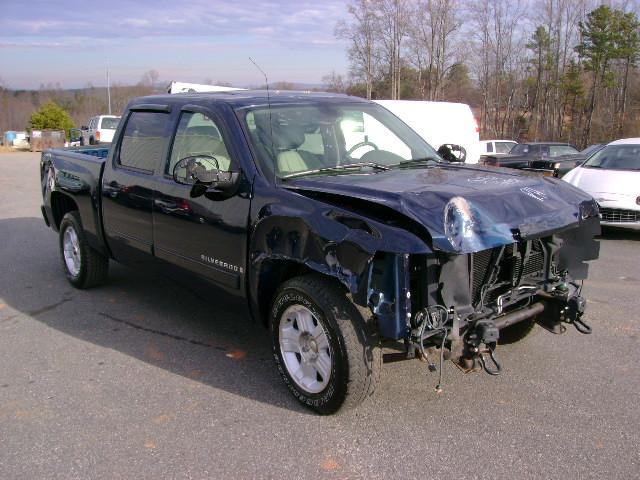

This is the way I got my truck , post-57232-1230474603_thumb.jpg wrecked and with no manual I had to buy 1 :D
