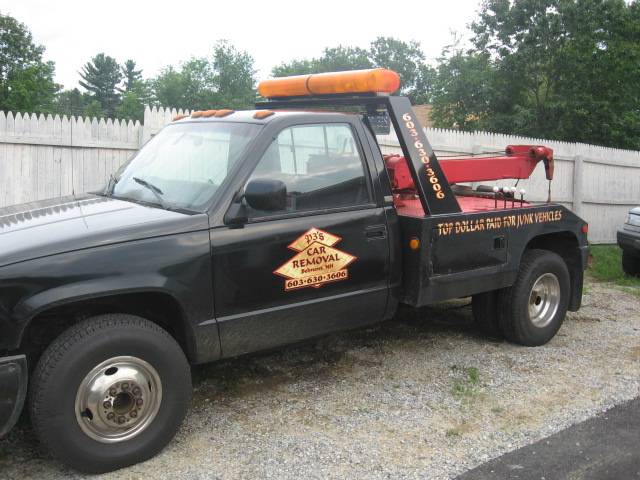

Hopefully someone can help,I am at a loss.I have a 97 3500 with the vortec 454.I was towing up a hill and it started running real rough,like it was missing a cylinder.I replaced the complete ignition system,plugs,wires.cap rotor coil module distributor.I changed the fuel filter,the injectors are only 6 months onld but I removed them and cleaned them,cranked the engine over to make sure each one is spraying and all looks fine there.The fuel pressure is almost 50 psi,the back pressure is 1.5 psi at 2k rpm,I did a compression test all cylinders have 135 psi except one has 125 and one has 140.I removed the new plugs,all look perfectlly clean except a little heat discoloration but one was slightlly black,not bad but not as clean as the others.I swappped that one with another cylinder to try to isolate a posible problem,I wont know until I drive it again.There were 2 codews,one for a o2 sensor and one for bank 1 rich.I cleared them and drove it for around 10-15 miles and they have not come back on yet.The cam retard was off,it was at 7-8 but when I replaced the distributor today I rest it back to 0.I plan to remove the valve covers to look for maybe a broken valve spring but other than that Im at a dead end.I just dont know what else to test or check.It idles ok and if Im not on the gas going down the highway is seems ok but when I give it gas especially when taking off from a dead stop the truck shakes and has no power.Any ideas?Please help.

Hey 66 nova,thats a nice car what does it run?I tryed to put in a couple pics of my truck and camaro but Im not sure if I did it right.The camaro is a 91 with a 383,edelbrock rpm cam,heads,intake etc,Hyperutectic pistons.1.6 roller rockers,150 shot of nitrous,10.5 to 1 compression bg 750,brand new 9" moser rearend,pro built 700r4 with 3000 stall,6 point cage,sphon drag sway bars,frame connectors etc etc etc.Now I just have to get it to the track.
