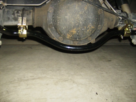

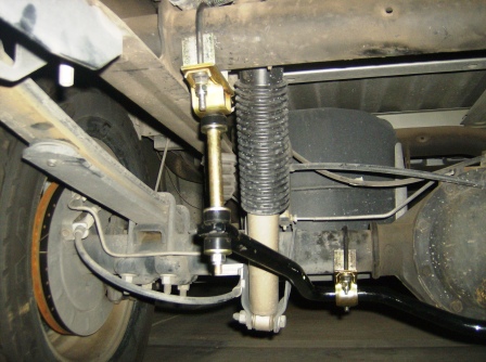

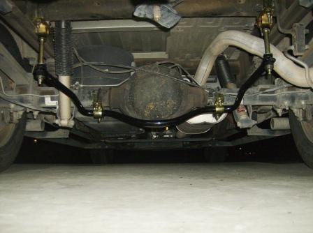

At 100K miles, I finally put on a rear sway bar on my 02 Silverado 1500 ECSB 2WD. After driving with it for about 2 weeks, I would say I should have put one on back in 02. Before even I had gotten a custom engine tune. It makes that much of difference in ride quality and handling of an empty truck.
I was going to buy a Hellwig, but any time I had called to check availability from the various companies that sell them, they would call 2 days later to say they made a mistake and they didn't have it available to ship. Back in November/December, Microsoft's Live.com was giving 25% cash back for buying on eBay with Paypal. I found a seller with an Addco 631 and after cashback, with shipping, cost me $145 total.

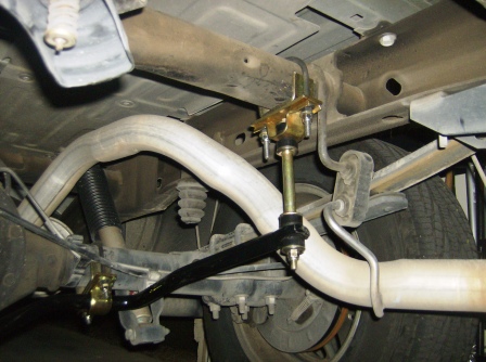

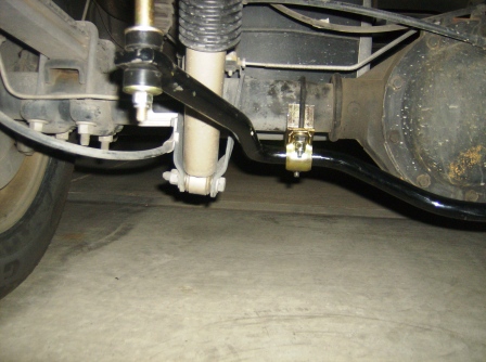

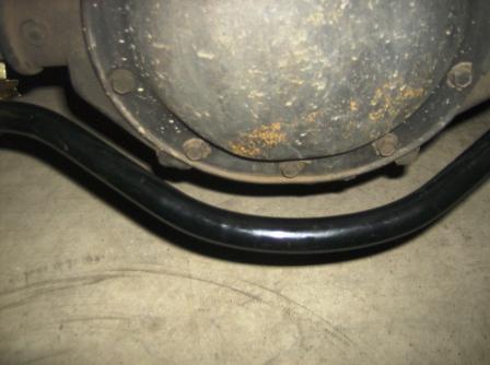

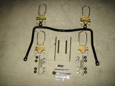

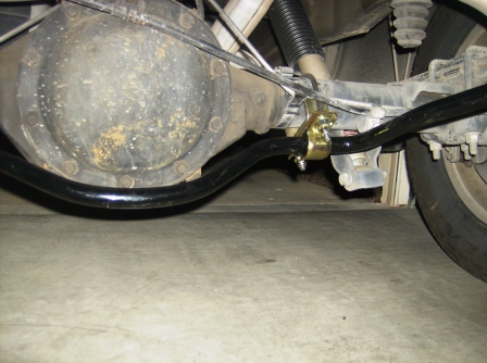

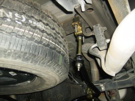

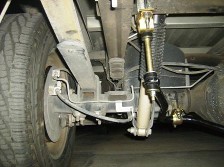

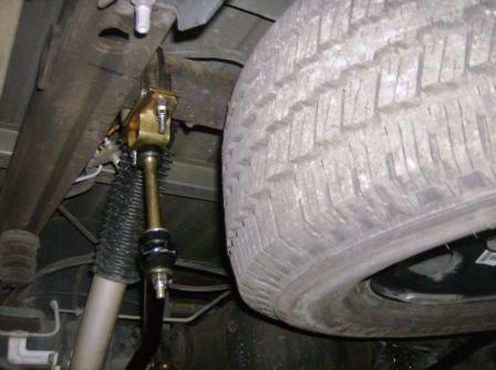

The Addco is a solid bar like the Hellwig. Nicely finished powered coated like the Hellwig. And is just slightly smaller in diameter of the Hellwig. The kit contains 2 sizes of end links, I used the short ones.

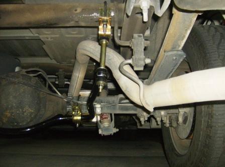

It took longer to get the jack tools out, remove the spare tire and put the spare and jack tools back then it took to install the sway bar.
BTW, if you have a spare tire, make sure you check the air in the tire on a regular basis. I never checked it in the past 6+ years since new and it only had 10PSI.
Tools I used was a floor jack (a friend could help you out) to lift the bar up to the axle to help mount, 9/16" combo wrench, 9/16" socket wrench with 3" extension. Dielectric grease for the sway bar bushings.
I have stock exhaust, so there was I had no clearance issues.
Note: The kit I was shipped (pictured) had 5" long U-Bolts. They seemed to be a bit short just to loosely mount the sway bar. A call to Addco and they quickly shipped me out 6" long U-Bolts.
:lol: Hi, I have an 02 also, looks like I should really think about adding the rear sway bar. By the way, the most interesting thing about your pictures isn't the sway bar, it's how clean the underside of your truck is. Here is MD, not many rust issues, but my 02 came from Maine when I bought it in 04, it sure doesn't look like your truck.
